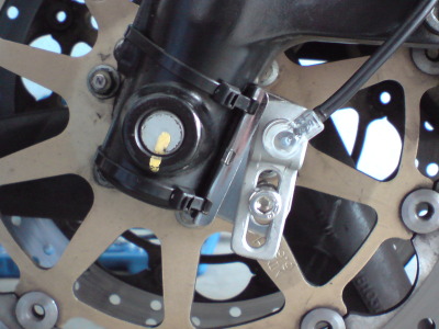

If you would like to get rid of the magnet sensor on the front wheel you can use the S-4 sensor cable from Acewell. It fits on the transmission in place of the stock speedo cable. You may have to change the wiring plug but its only two wires. You may have to recalibrate the speedo ratio also, I did mine with the gps on my Iphone.
Posted Image

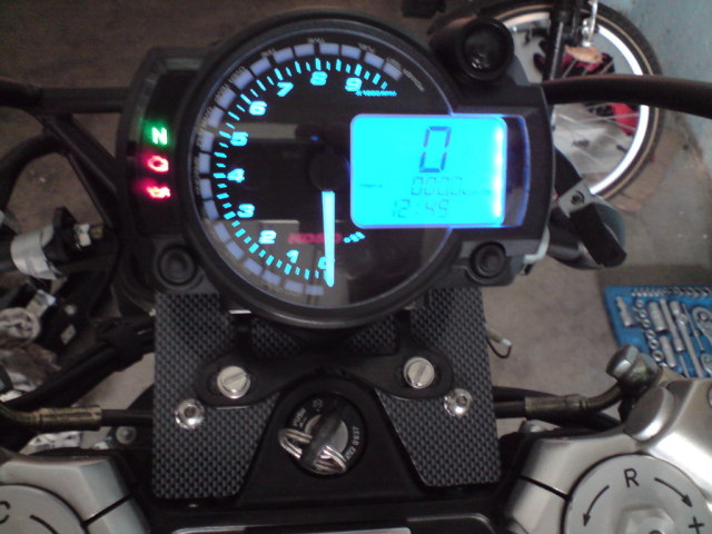

Where did you mount this censor? I assume if you wanted to get more or less accurate outside temp readings it had to be as far away from an engine heat as possible.
I squeezed it together with the cables into black box, which I "velcroed" under the dashboard. See silver thing protruding out of it? That's it.
