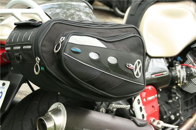

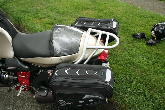

Just completed a conversion to a newer saddlebag, I used the Oxford Humpback. Took the belly plastic out of the Teckno used a heat gun and jigsaw to shape it to the Oxford. Oxford had a zip in belly reinforcement but wasnt rigid enough to hold bag shape properly, good news is the Tekno part once cut and shaped zipped right in! Off to plastic shop had 3/16 ABS cut to match inside face of bag, drill out holes for Klickfix mounts and Keyway, add a couple aluminum brackets to attach back plate to belly plate. Propane torch and a coat hanger for holes in bag and strap removal. Bingo a top loading quality bag with proper zippers utilizing the Klickfix latch, passenger pegs still accessible, for 50% of replacement cost! After reinforcing the Tekno bag and nursing it along the last couple years I grew to dislike the side loading bag and those cheap zippers. For those stuck on Italian gear Aprillia now offers the Klickfix mechanism on their bags (same shite zippers, and self dump design). :)

Here are some shots of the Oxford adaptation. Oxford and Rapid Transit are two companies that offer top loading expandable bags with size options that were decent enough to put on the Guzzi. I chose the smaller as I wanted to access the passenger pegs and not overwhelm the machine. They are plenty big enough though, the seat cowl fits in them and there is plenty of storage for a week long camp trip. The zipper on the centreline of the interior of the bag is where I installed the re-shaped belly plastic from the Tekno bag. You can see the edge of the 3/16 ABS back-panel on the inside. Had to buy slightly longer metric mounting bolts for the Klickfix latch, and new bolts for aluminum brackets. Just melted off the stock mount straps with a red hot coathanger and cobbled the brackets from some angle stock. I guess a guy could put cap nuts on the inside if you didnt want any runs in yer nylons. Anyway, there's a luggage option for any interested. :thumbsup:
