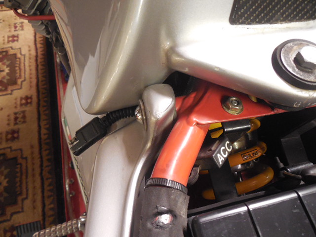

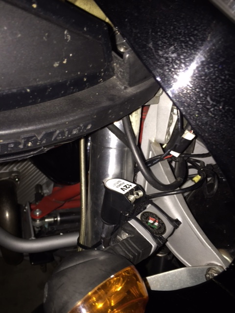

I would consider something a little better than the lighter socket.... This is the style connector used on BMW bikes. You will of course have to use the male & female connectors.
