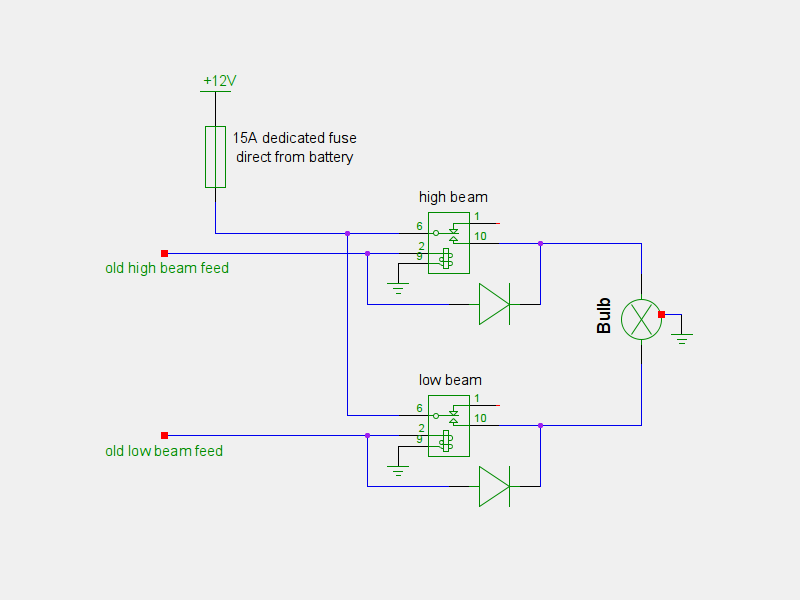

I would also like to have it so the headlight doesn't come on as soon as you turn on the ignition.
Quick'n'dirty idea (I don't think this is an important function at all but I like playing with thoughts): Add low and high beam relays as has been described in various threads, but let the oil pressure sensor be the low beam relay coil's ground path.
Very important: Leave the high beam relay independant of same sensor in case it decides to give up at speed, in the dark...
Edit: I don't think I'd implement the above but I just realized there is a way to protect yourself from losing headlight due to relay failure. Just add diodes between the relay coil's positive side and the N.O. contact that goes to the bulb (later edit: can't have that diode together with pressure switch, see later post). This I will implement. I already have the relays.
EDIT: The previously posted pressure switch schematic will not work. The pressure switch is closed when we don't have oil pressure, so we'll have to invert it. See http://www.v11lemans.com/forums/index.php?showtopic=15686 for further discussion.
Raz,
That's very clever!!!!
Did you guys see that, he's using the Oil pressure switch so that the headlight doesn't come on until the engines running (the switch is left on low beam)
He's added the two diodes around the relays so that each beam has a backup supply, If the main fuse blows it feeds through the diode all be it a bit weaker.
My hats off to you Raz, I'm going to steal that idea.

Thanks. Unfortunately, I think we'd have to leave that extra diode off the low beam relay, right? Otherwise the pressure switch can't stop the low beam from going on because it will use the backup. I didn't realize until now. Personally I think I'll use both diodes but leave the pressure switch out of the circuit. My battery can power the headlight for an hour with power left to crank the engine.
I edited the picture in my previous post, removing the low beam diode.
For completeness, here's the same with no pressure switch:
Diodes must be rated 5 A or higher. For the new 12 V feed I used 1.5 mm2 wires.

Raz,
I think your latest post is a good compromise, it is an easy upgrade, just one new wire from the battery and some simple wiring inside the headlamp.
I would say only one thing, you should use the same relays and fuses the rest of the bike.
You might also consider one of the self resetting circuit breakers instead of a fuse. (recover after an intermittent short)
If you loose F5 you will still loose all lights but it would be very easy to hot wire across to get you home.
I came up with a slightly different circuit using 2 relays and the oil switch. One relay used as a change over so it fails to Low Beam but I will try to stay focused on the wiring schematic.

I bought a complete set of GEI relays from PyroDan a couple of years ago and I ordered two extra for the lights. Most of the old Siemens relays are fine so I'll use one of them for the horns (which can be wired similar to one half of the headlight relay schematics, including a diode if you want but not the pressure switch :lol:), haven't got around to that yet. One of the others I carry as a spare. Actually I used one of the existing fuses for the new feed, I think it was the horn relay. Mind you my Sporti is not wired exactly like the V11, I just picked a fuse with constant battery power and not much other load on it.
I use spade connectors to the relays instead of sourcing proper sockets, covered the lot with electrical tape and tucked it behind the headlight. I don't remember the original voltage drop but I remember it was a LOT. I relayed it and replaced bulb with a 60/55 high end bulb and it was literally a night and day difference, pun intended. Light transformed from weak yellow bicycle-like light to a proper beam more like my car's. I've had it for two or three seasons now with no problems.
You are right about the fuse but I don't think it's much needed. I do carry spare fuses, in fact I found you can tuck one spare between every two fuses in the OEM fuse block, at least on my bike.
Speaking of relays, one day my bike just died on me while overtaking a couple of cars. It put me in an awkward position but I managed to get to the roadside alive and start looking for the fault. It turned out the power relay had completely vibrated out of its socket. This after tens of thousands of kilometers with no such problems. The other four relays were still properly seated. I pushed it back and carried on. Weirdest thing, the whole scenario repeated (including me overtaking cars and the awkward position) within 150 kms on the same trip. Same relay had popped out again. And even weirder, it never happened again after that! The bike must have had vibrations in just the right harmonics that day. Anyway I ended up zip-tying the relays to their sockets. I think the proper fix is pinching the spade connectors inside the sockets, that is on my to-do list. Or maybe I should use hose clamps :grin:
