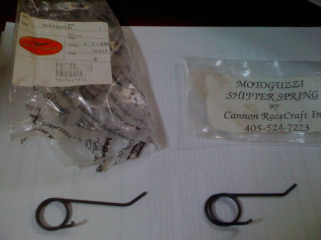

****Update***
I checked to see if shifter was making contact with porkchop and was not the case.While looking for something in shed I found box of spare parts from PO.It had Cannon Racecraft spring in a labeled open package,so don't know if it's an actual Cannon spring.I also ordered a MG spring from MG Cycle a while back in anticipation of opening cover,and don't know if this spring is the more recent MG part.Dont have camera now so cant take a good pic but they are different.Slightly different shape hook,length of arm,and loop.I know PO changed spring a couple times so dont know what was the last one installed was.I know I can measure it I just dont have a tool to get an accurate reading.
Sooo,
I guess I gotta open the cover again,bummer,......
Any thoughts would be more than welcome,
Belfast,Baldini,Greg,,?
Thanks

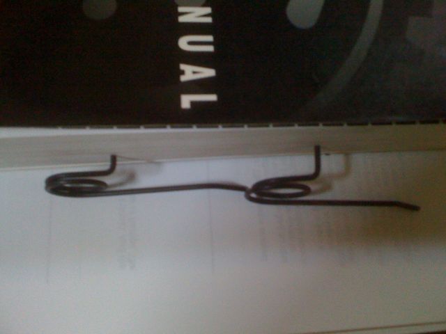

I think you can check the wire diameter to tell the difference between the Cannon Racecraft spring and the Guzzi springs. The Cannon spring that I had was made from thicker wire than either of the Guzzi springs, stock or "improved". From memory I got 15k miles out of the stock spring and 7k out of the Cannon spring. The improved Guzzi spring has about 9k on it now.
This should be a pic of the broken Cannon spring and the new Guzzi spring. I posted this pic with a description quite a while back but I can't find the thread with the search function. Maybe it's too old :huh2:

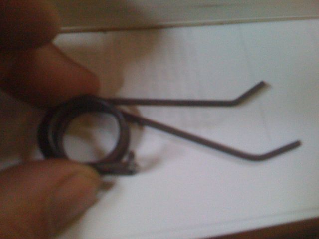

Thanks Tom I'll have a look at it when I open it up.Here's some pics of what I know is a new MG spring and what I believe is a Cannon,
