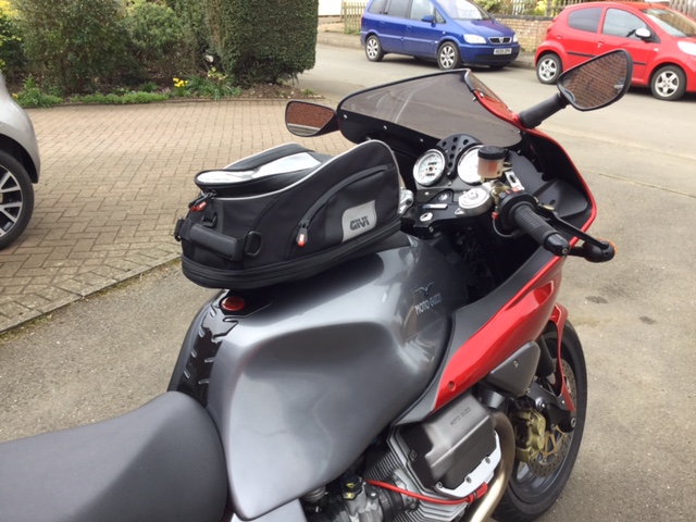

I know this discussion has been ongoing for some time but I'm new on here.........I made an aluminium "horseshoe" to fit under the givi tanklock ring which together with suitable bolts raises it up enough to clear the tank pad while still giving the bag a solid base to fit onto.( my bike is a 2002 lemans).
I use a givi xstream 15ltr bag which sits great on the ring and is big enough for a day trip or even an overnighter if you travel light.
A small amount of fettling was required on the ring to allow the petrol flap to open but otherwise it was fairly straightforward. The bag is very secure and does not restrict movement or view to the instruments. I can supply pictures if anyone wants them.

Yam350 many thanks.  That bag sits more forward than I would have thought.  Does it have more than one location for the ring, i.e. can you remove the ring from the bag and move it to another set of screw holes?
