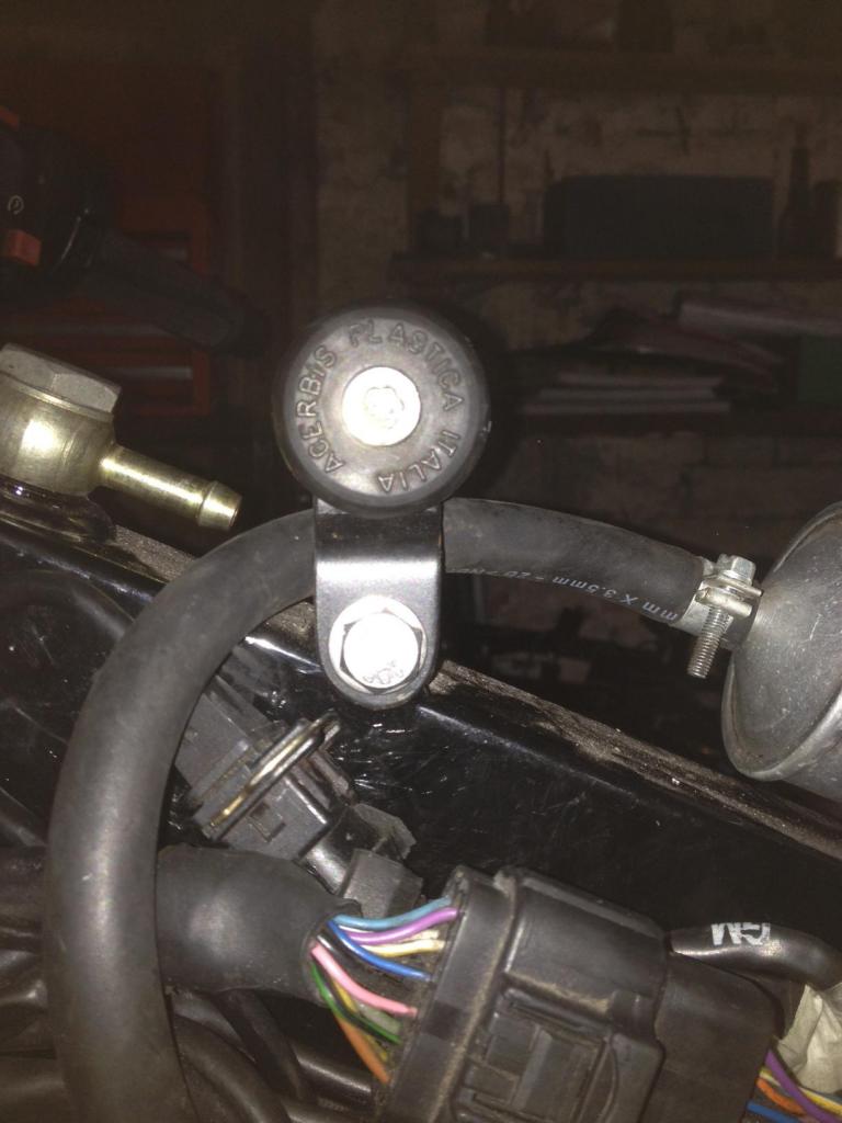

Lucky Phil Posted September 4, 2014 Share Posted September 4, 2014 Hey gritman I'd be interested to see a photo of your fuel tank mount solution. It needs to be raised about 30mm correct? Ciao Link to comment Share on other sites More sharing options...

Gritman Posted September 5, 2014 Author Share Posted September 5, 2014 Hey gritman I'd be interested to see a photo of your fuel tank mount solution. It needs to be raised about 30mm correct? Ciao Yep, 30mm is about right Phil. Photos of my riser below..... Goodness, look at that dust! Hope the pics are ok, essentially a pair of offset brackets held together by a piece of threaded welded tubing that accepts the stock tanks mount rubbers..... Link to comment Share on other sites More sharing options...
Lucky Phil Posted September 6, 2014 Share Posted September 6, 2014 Thanks Gritman, simple yet effective solution. I'm still rebuilding my V10 engine for the swap, so this is all great info and time saving for me. Ciao 1 Link to comment Share on other sites More sharing options...
