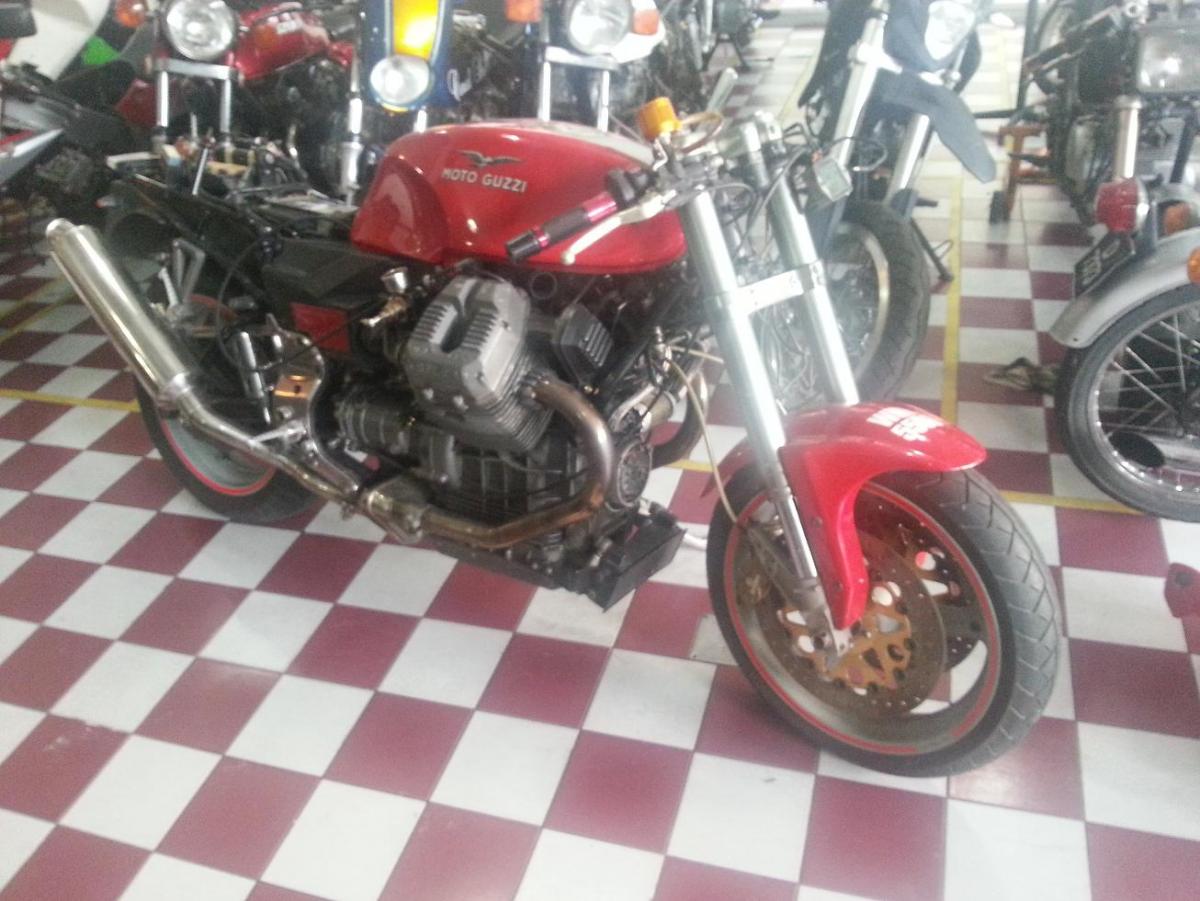

Sam 84 Posted April 25, 2013 Author Share Posted April 25, 2013 Fair enough. Gotta do what you gotta do. But how bad is your Daytona motor? They are usually pretty stout. To honest with you, I don't have a clue. Just bought the bike a few weeks ago - in unstarted engine and some bodyworks dissmentled condition. So yeah, I paid for it without even listen how it sounds. All the engine parts need to be replaced that I mentioned earlier are based on the previous owner's story. Hope its not worse than that! But with only 2 units Daytona RS known to be in Malaysia, I just have to take my chances. So basically I'm just prepare for the worst - engine transplant. Hope won't need it tho.... Attached a few pic for you.. Link to comment Share on other sites More sharing options...
Sam 84 Posted April 25, 2013 Author Share Posted April 25, 2013 Pardon the dodgy pic...using my handphone Link to comment Share on other sites More sharing options...
Sam 84 Posted April 25, 2013 Author Share Posted April 25, 2013 Link to comment Share on other sites More sharing options...
