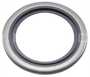

Looks like a bonded seal washer would help here, you know, a washer with an o'ring bonded inside it. Also known as a Dowty Seal.
Link to comment
Share on other sites
Looks like one to me.
The clever part is how they seal, it does not really seal around the shank of the bolt so does not matter if on the threaded portion. Any leak will pressurise the seal outwards/radially this will make it thicker and so press tighter on the flange and the underside of the bolt head. The higher the oil pressure, the tighter the sealing action. Obviously the flange needs to be flat.
