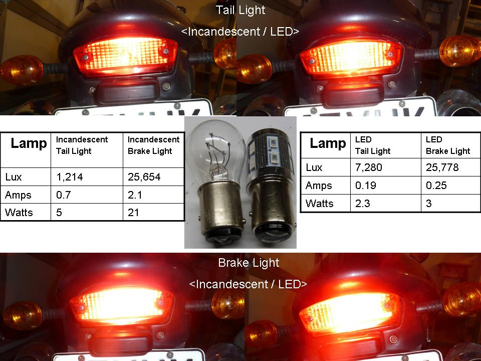

I bought a LED tail light bulb from: https://www.aliexpress.com/wholesale?catId=0&initiative_id=SB_20170527141419&SearchText=LED+red+1157
I'm pretty happy with it. I was going to replace the tail light lens but didn't want to do this until I had a LED lamp which is cooler than the incandescent bulb. The lens has a burnt area just above the bulb.

I tried an early made 1157 type LED in my tail light, but it didn't even look like it was on from the side, dim from an angle (only bright straight on). How doea one look from the side, does it illuminate the red lens?
Some pictures from various angles with only the tail light on, not brake, are attached. This partcular 1157 LED lamp does have good side beams. This is the first one I tried that didn't immediately get thrown into the parts bin. There is some real junk that you can buy on Aliexpress.
I also added small arrays of LEDs at the sides of the taillight, taken from a previous attempt to find a good LED lamp. You can just see the light from two 12v arrays connected in series, wired to the taillight circuit, and put in a dark area of the taillight assembly where the reflector casts a shadow.

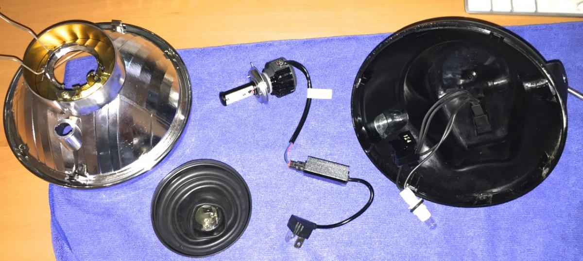

Thanks gents, for this thread. Here is the H4 LED headlight from GuzziTech - with OEM bulb for comparison.
The electrical is plug and play. I connected it to the bike and it is WOW bright.  :sun:
BUT.... I cannot figure out how to close the light with all the extra bits in there. The base of the LED light (with a fan in it) takes the same space that the plug used to take - now I have to squeeze in the plug and the black box. Been at it for almost an hour...  :angry:
I'm tempted to cut out some of the ring that the OEM rubber boot goes onto. But before I start cutting, it would be great if somebody could "enlighten" me about how all this fits in the bucket.
Maybe my Sport bucket is bigger than your Scura's.
All of the ballast and bits fit in mine, although I had to push everything to one side where there was room, outside of the ring surrounding the bulb hole, if that makes any sense. I also had to keep the ballast thing lying flat to close up cleanly.
Make sure you have the bulb base and the slots aligned correctly, as it only goes in one way, even though it appears to go in any way. Correct alignment will reduce the profile just enough to clear the bucket.
That being said, it may be that the Scura's bucket is shallower than the Sport's.
I would just cut away what you need to to make it fit. It's not like it's a Vincent Black Shadow..... ;)

Thanks JB. Just tried again, still can't make it fit.
I thought, perhaps, you were being generous by offering that your bike's headlight bucket might be larger. Then I went to Harper's website parts diagrams - and wouldn't you know, the headlight on the Scura is different than all the other 2002s. It's a tight, little, black, form-fitting headlight cover. Just one more way the Scura is special...  FWIW - the Scura headlight bucket looks quite large in the attached illustration. I can assure you that is not the case.
I'm certainly not worried about maintaining the originality of the backside of a plastic headlight insert. However - I think I will try this light on the LeMans, which has still a different bucket. I'm going to try the LED headlight Marty recommends in the Scura - no extra plugs or ballast on that one.
