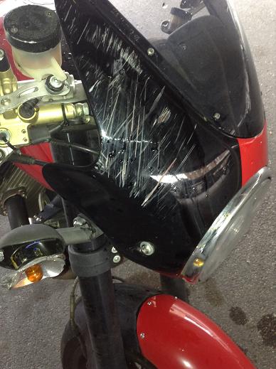

d1jezek
Low-sided in the rain the other day and scuffed up some painted parts.  This one might have been after-market.  I bought her used and mostly thought she was stock, but the mirrors are Rizoma and the hand levers are CRG.  Harper's didn't have this part listed in black with red.  Is it actually unusual? has anyone seen anything like it?vida 001b.JPG
Link to comment
Share on other sites
I was thinking that is the Givi style screen available for the Sports 2002 and on. The early screens are Stucchi and fibergalss.
It may be the same or very similar to the Centauro screen. Come to think of it, didn't Centauro come in that black with red stripe?
Link to comment
There you go! Late model Scura R (likely 2004 production sold into 2005). Pretty rare, I'm thinking, but maybe a world wide search would turn one up (MI, MPH in USA, TLM in Netherlands, HMB - Germany.
Looks the one i your link has a different windscreen and maybe a sticker or decal but otherwise the same fairing.
Link to comment

Got the fairing/windscreen repainted.  If you're in Houston, by the way, Excel Frame and Front End did a great job matching the paint. My current bit of confusion has come because the mounting brackets seem to be different from stock.  I called Harper's and described what I have and how it differed from the exploded diagram I saw on their site and after a while I was convinced that the woman there had found what i needed.  But it is the part as shown in the diagram and not the mounting hardware on my actual bike. Instead of a central mounting point with two arms supporting the windscreen, what I have are two individual arms which mount at the top of each fork tube. So is this the Givi screen after all? I think I can probably bend the deflicted one back into shape and just repaint it.  Doesn't look broken, just bent to the wrong angle.

I don't think any of the factory bikini fairings are frame mounts.  They all hook on the headlight.
I only know of two made specifically for the V11: Guzzi & Stucchi.  They are different with different windshields, I know because my windscreen got broken (I don't know how but I think it got smacked in the parking lot at work) and I almost ordered ordered the wrong after market style windshield from MG but instead I got the factory windshield from MPH.  My bike has the carbon fiber factory bikini fairing.  Stuchhi had a color match.  I've not seen them on the MG website so I wonder if they are no longer available?
True, yet some V11 variants mounted the headlight and instruments from the frame not the forks: beginning with the 2003 Café Sport then Ballabio, Coppa Italia, Scura R (not the original 2002 Scura)  . . .
A V11 Naked remained available through the end of production that retained the closed fitting Fork mounted bikini faring.
