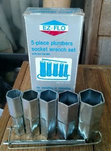

I chickened out replacing my tensioner last time I had the timing cover off. I did get myself a set of plumbers sockets that you could put a crescent wrench on. They would/will fit over the crankshaft.

I got motivated and zipped out to Lowe's to buy a set of those plumber sockets. The size was not exactly right, but I tried anyway - and just ended up deforming the tool without moving the nut. I guess this is going to take a few trips to tool stores.  :luigi:

 That is why I mentioned that they are weak lol. That is the main reason I have never used them doing plumbing lol. But I tend to mostly do very old plumbing say from the mid 50's on back as nobody really seems to know a darn thing about it today lol. Back to the stamped sockets lol. That is why I get a socket of the correct size needed and modify them. I had a few I made up years ago but gave away from lack of use but what I did was use a hack saw to cut the back of the deep well socket off where the driver would go and cut and fit a piece of pipe that would be needed at the correct length and then simply weld them together. :) You can make any depth of a socket you need doing this. And I am positive with all of the great work I have seen on this forum it would be no big deal.
 While we are on the semi subject of plumbing I will talk about Electric water heaters lol. If you have to replace the heating element in one do not waste your time with those cheesy stamped wrenches. Spend the funds on the 1/2 Dr Deep socket that is needed. Believe me you will be very thankful.

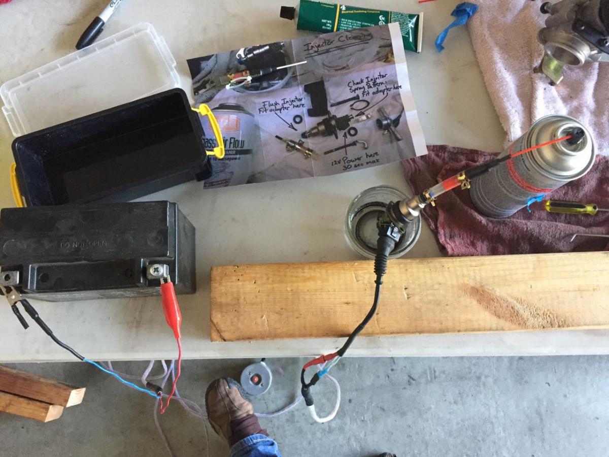

Little update - got the deep socket yesterday. The timing gears are out and I'm going to start stripping the engine paint today. There's nothing like having a proper tool - and I'd be happy to loan it as needed.
Yesterday I also received a nifty new fuel injector cleaner (also available for loan):
I sent MartyNZ a pair of injector plugs from an old wiring harness and he made them into these fabulous injector cleaning kits. Nice long leads to attach to a battery (even if still on the bike), quick-connectors for the injector plug (so it can be used with other types of injectors) spray bottle adapters, clamps, etc. everything to make it super-easy on this first-timer (me). And here's the super-cool factor:  a foot switch so you can hold the injector and spray bottle with two hands. And the super-super-cool factor: Marty put a light inside the wires - so it lights up when the injector is open. I probably over-cleaned the injectors just so I could watch it light up.  :nerd:
Thanks Marty.  :wub:
