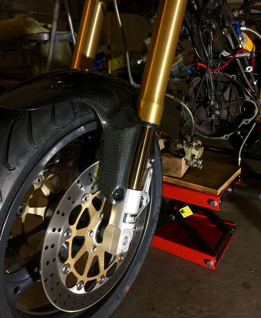

More play time  :mg:
Rebuilt forks, new fluid in damper, fresh Pirelli Angel ST, groovy new front fender, lots of little stuff like cleaning and lubricating the wire harness, playing with ground wires, new speedo cable and angle drive (the previous cable had snapped and left a piece inside the drive gear).
Still haven't painted the engine... but getting there. Hopefully I can get it going again before the New Year.

Merry Christmas and Happy Holidays to everyone!  Scud- where did you source the front fender? That looks awesome on the bike.  One of the major and only disappointments I have with my bike is the black PLASTIC FRONT FENDER  Guzzi saw fit to install on the LM.

I found the fender on eBay.  Details here:
http://www.v11lemans.com/forums/index.php?showtopic=19514&p=215632
Jester and I had some PM conversation as he was also interested. The fender is for the Ohlins forks, and it would not be a direct fit to the Marzocchis - the zooks take 3 screws per side and they are in different places than the 2 per side of this one.

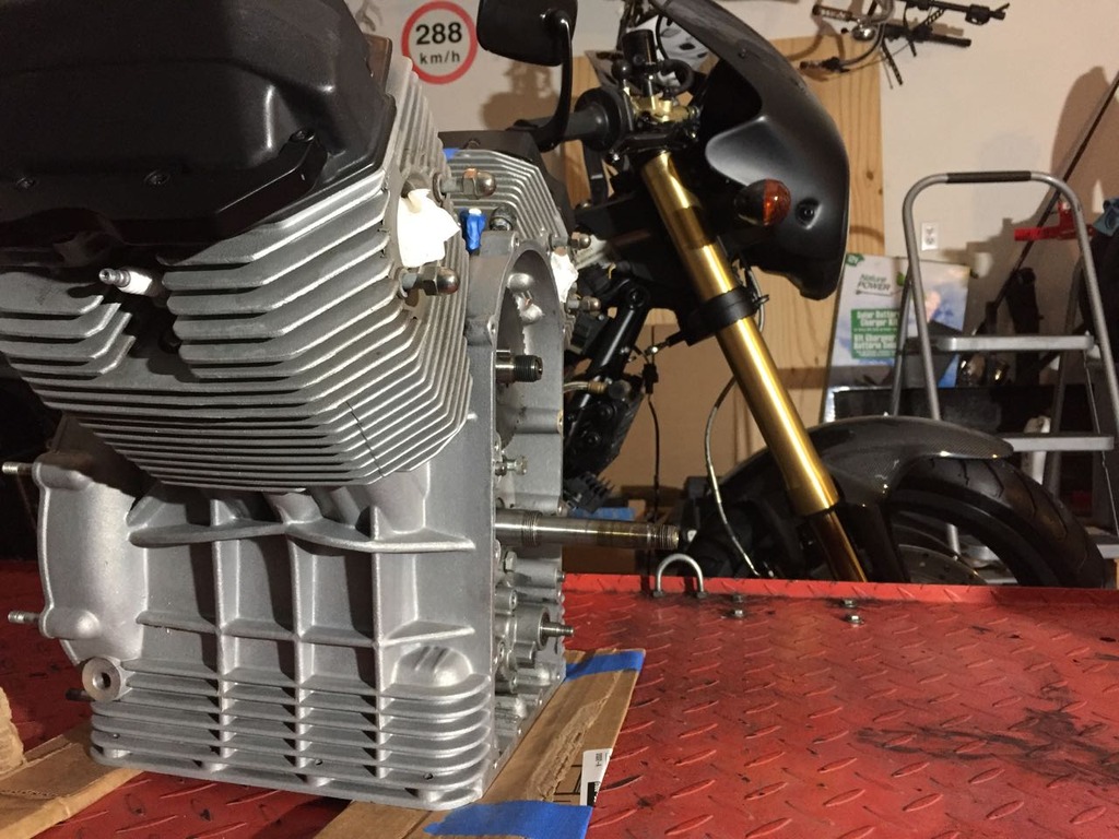

Meanwhile, Santa's elf was busy stripping the engine case.

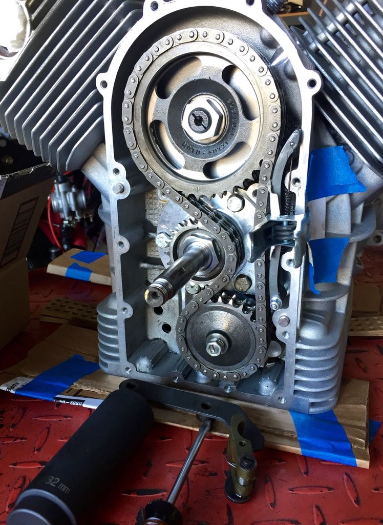

Following up on my earlier puzzle about the timing chain... I got it back in today, along with the upgraded timing chain tensioner... and there is a bit of a trick to it.
First, the new tensioner has to be compressed by something skinny enough to allow the chain to slide by. Standard C-clamps did not work. I took all the rubber tips off a spring-clamp and it was smooth and easy.
Then, all three gears and the chain have to go on at the same time. And this can be done with only two hands:
  • Get the gears and chain all properly organized so the marks will line up. It would help if you were able keep them together after removal - but did I do that? No.
  • When you get the cam and crank gears to start over their respective pin and slot, then you have to line up the key and slot on the oil pump. This can be done by turning the oil pump shaft with a screwdriver. If your oil pump gear has the slot close to the top the little key will not fall out.
Snug it up... 150nM (110lb/ft) on the cam nut. No torque specs provided for the nuts on the lower two gears.
And WOW - the chain is WAY tighter than with the stock tensioner.  :D
Special tools: a super-deep 32mm socket, and if the motor is out, you need a starter gear locking tool. BTW, the bolts that go through the stock tensioner are longer than the other bolts around the main bearing housing - so I needed one new, shorter bolt.
