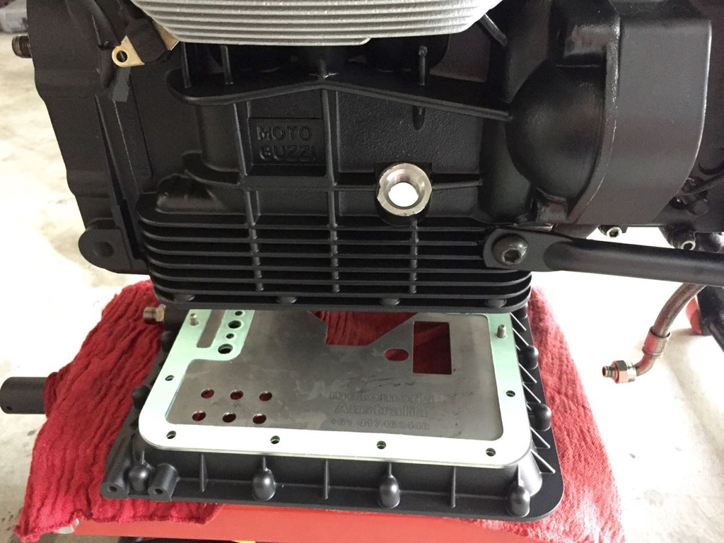

The way I install the Valtec type tensioners is to put the plate on and then the chain and sprockets before finally slipping the blade and Spring over the pin and pushing it home. Then install the washer and nyloc nut. Easy.

Hey Pete - I was thinking of you today. This is third time installing one of your "Roper Plates." Second time in this bike. I think I'm marginally proficient at it now.

And now is a good time to put level markings on your thermometer dipstick, while you can see it from below, poking down through the plate.
That is if you haven't already (I haven't on mine yet).

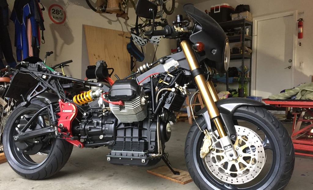

My New Year's resolution is: "Rub my hose less and ride more."

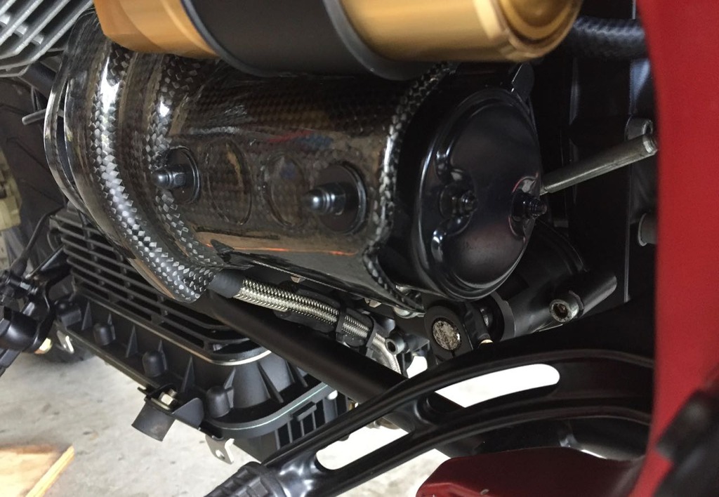

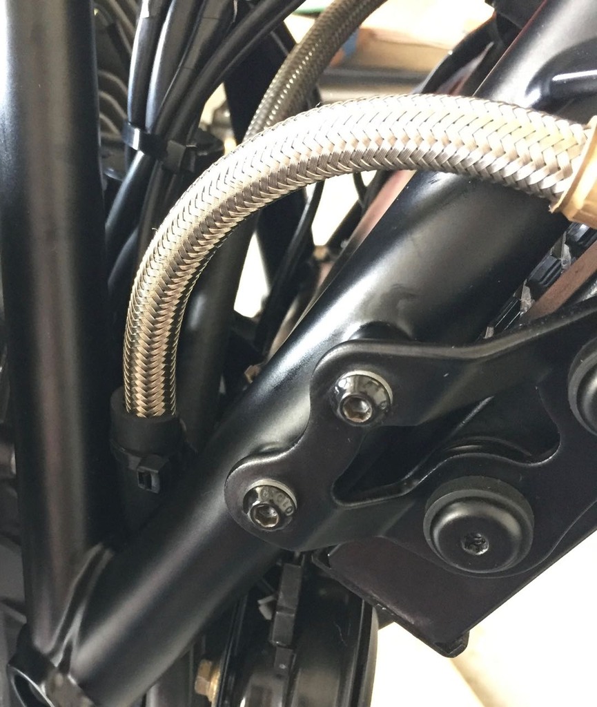

The RH oil cooler hose had rubbed through the thin rubber and the paint on the subframe - so wrapped the offending section in a piece of split heater hose.

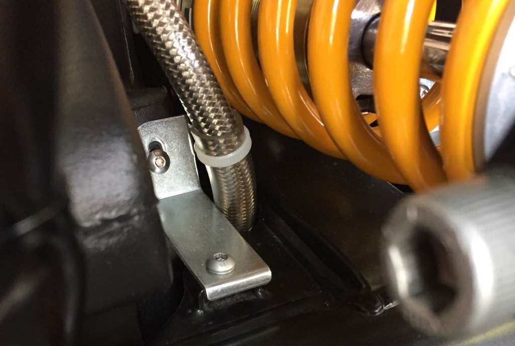

The hose to the shock reservoir had burned through paint on the frame and I didn't like how it was rubbing against the airbox bracket - and I had some clear vinyl tube in my toolbox.
This oil hose had rubbed through the paint on the subframe, and it rubs on a sharp edge under the transmission - so more heater hose to protect it.

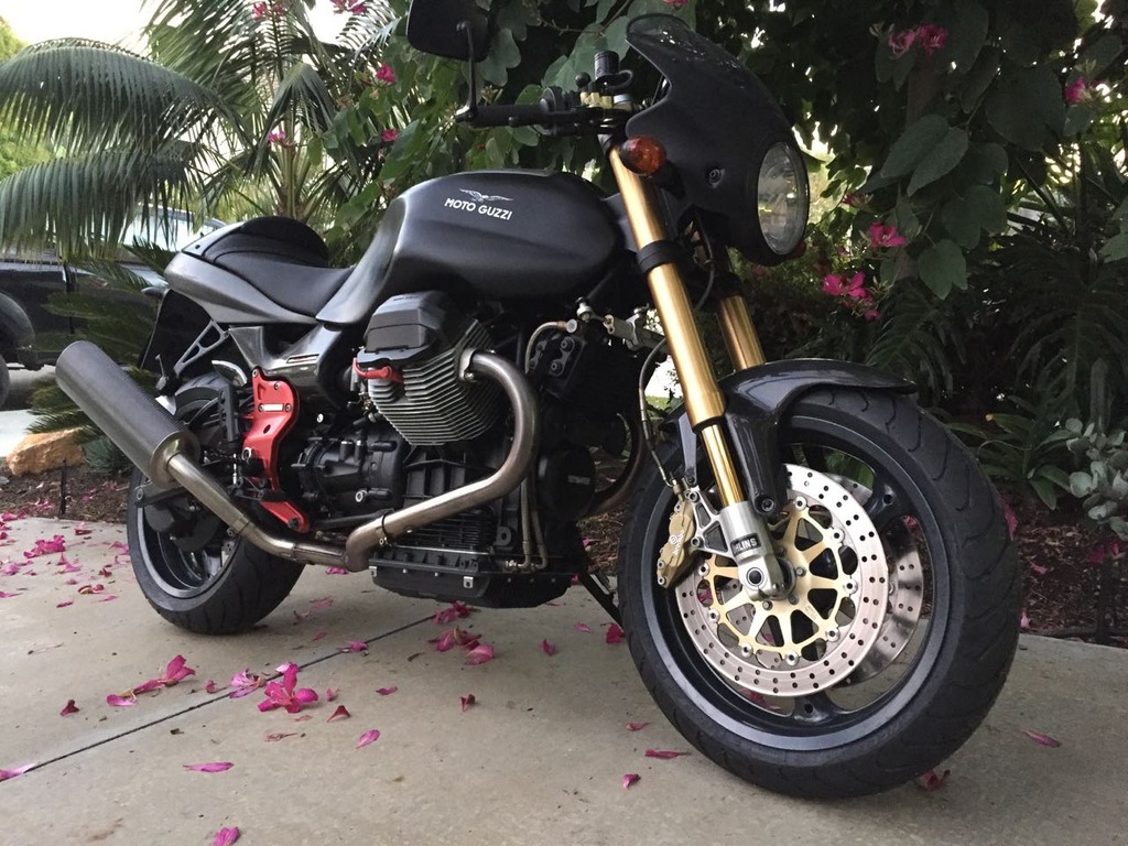

And here's how I'm going to ride more...
Still have a lot of fine adjustment and tuning to do... hoping to get it through a few heat/cool cycles and get her out for a proper ride soon.  And where did I stash that belly pan?  :huh2:
