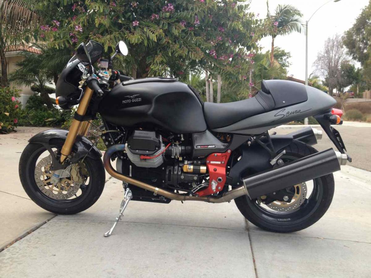

I picked it up from break-in service today and rode home on Pacific Coast Highway. The exhaust valves were too tight and it needed valve cover gaskets. No other issues.  :D
Since I need to flush the clutch and brake fluids, it seemed the ideal time to start the dark  :ninja: ening.  I got black Rizoma fluid tanks to replace the clear plastic tanks on the bars.
Sadly, wrenching will have to wait, because I have to leave again tomorrow for work. However, it was urgent to remove the orange reflectors from the front wheel. They were blocking my view of those lovely 4-piston calipers.

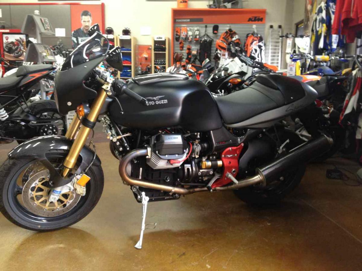

Here it is on the floor at the dealer... where we first met  :wub:
I'll take some pictures with a good camera when I get home.

Does yours come with the factory bubbling paint? Pretty common for the Scura.
No sign of bubbling paint so far. It's perfect really - like a time-machine dropped it off. I would guess that the bubbling shows up after several heating and cooling cycles - which my bike has not had many of (yet).
Let's assume that MG used a very slow-acting hardening agent in the paint... therefore it has finally set after 12 years of non-use and I won't have any engine-paint problems.   :not:
