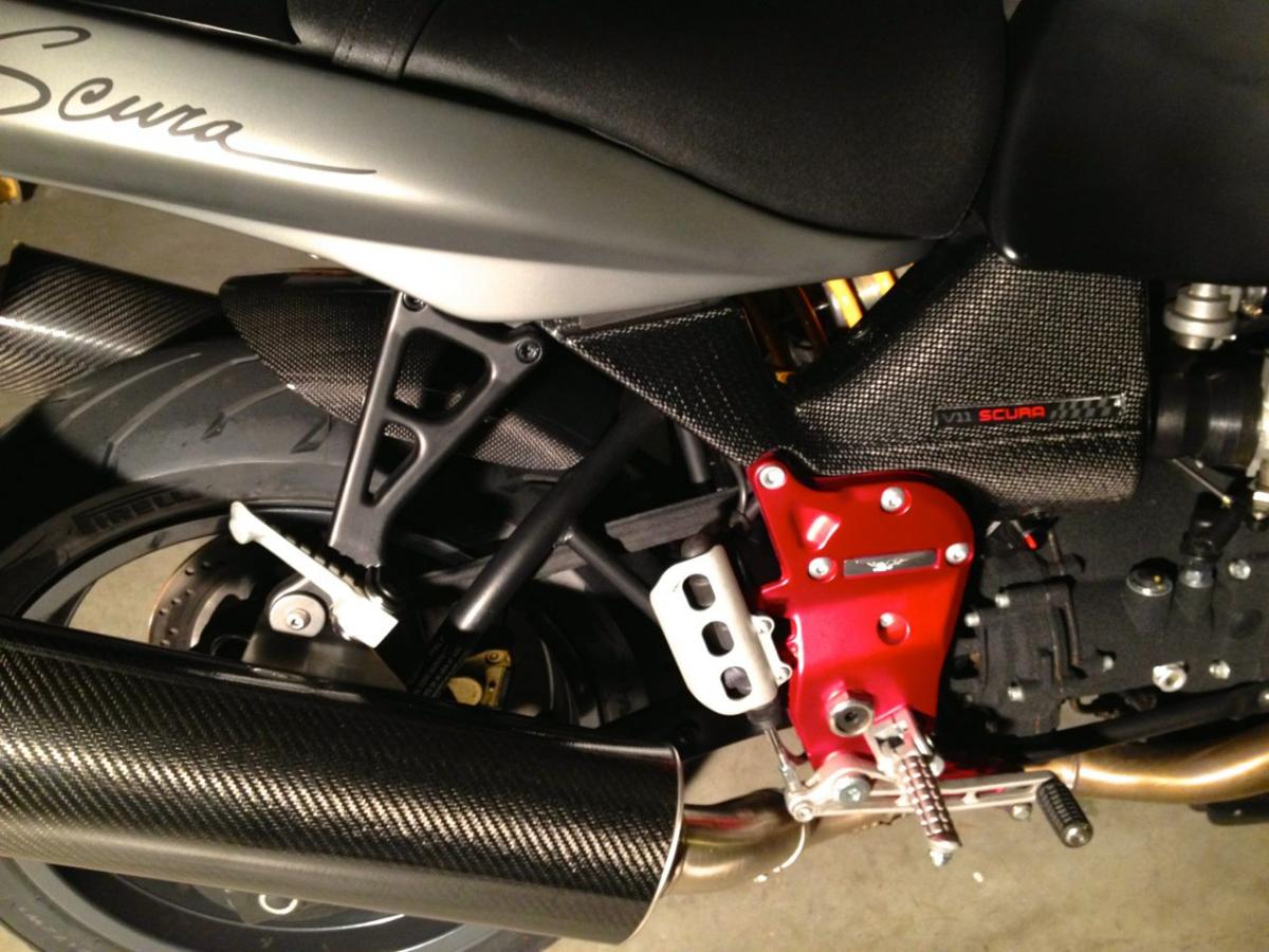

Here's the finished project:

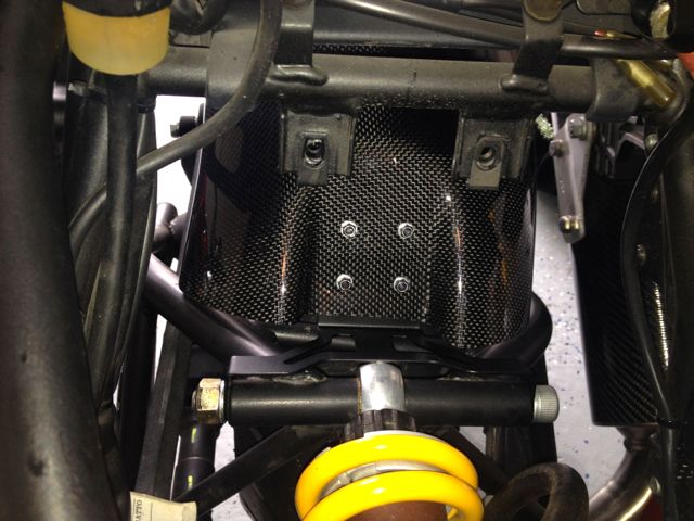

Removing the battery and tray is the way to go. I had the nuts inside the fender originally and figured that was a bad idea. Swapping it was a breeze with the battery and tray out of the way. In this picture, you can also see how the fender is not mounted squarely to the bracket - because it aligns to the non-square swingarm.
The fender itself would be a breeze to take off and on now - but I'm not sure why I would need to. It just seems to float over the rear wheel and I'm sure I can get the wheel out without removing it. Installing the bracket is what made this a big job.

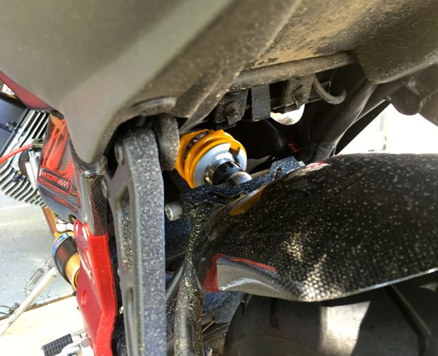

I got the Scura a little muddy today, which turned out to provide a nice spray-test for the fender. This this was the first time the bike got dirty, so you can clearly see how well the fender protects the shock from spray. Other than a little bit of dirt on the lower mount, which must have bounced off the underseat area, the shock is still totally clean. I never got it dirty with the stock fender, but I'm pretty sure that the shock would have been a mess if ridden in the same conditions.
I bought it just for the look, and it turns out to be excellent protection for the shock. Cheers to Ghezzi-Brian for a functional and attractive design (although I grant that it was not an easy installation).  :bier:
