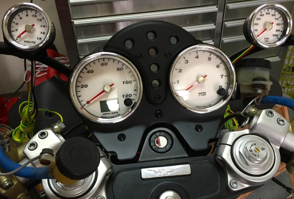

Scud Posted April 24, 2015 Author Share Posted April 24, 2015 Working on getting the Speedhut gauges installed. The thread "Installing Speedhut Gauges" is useful. I hope to rig up something to mount the oil pressure and voltage gauges either from the fairing bracket (as currently taped on) or on the large plastic panel inside the fairing. For now, just trying to make sure they all work correctly. So far, I got them to power up, light up, and acquire a GPS signal. ...and something must be done about those fluid tanks and blue hoses... Link to comment Share on other sites More sharing options...

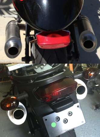

theoneandonly Posted April 25, 2015 Share Posted April 25, 2015 pillion hangers on round the wrong way in original pics ? Link to comment Share on other sites More sharing options...
dl.allen Posted April 25, 2015 Share Posted April 25, 2015 Great thread keep up the good work! I will be referring back to it in the future. What is the story of the exhaust cans? They were cut, shortened and welded back up? Are you considering aftermarket? I have been considering a cross over and cans for mine Link to comment Share on other sites More sharing options...
Scud Posted April 25, 2015 Author Share Posted April 25, 2015 pillion hangers on round the wrong way in original pics ? Those are Guzzi's factory-aftermarket exhaust/pillion peg brackets to go with the Titanium exhaust; they are correctly mounted. Great thread keep up the good work! I will be referring back to it in the future. What is the story of the exhaust cans? They were cut, shortened and welded back up? Are you considering aftermarket? I have been considering a cross over and cans for mine Exhaust cans were also part of the factory Titanium Kit Racing accessory, along with a new ECU. I didn't get the original hangers, exhaust, or ECU. This kit mounts the pipes higher and tighter than stock, which looks cool but makes it impossible to mount standard luggage racks. I think that's why the PO disassembled the cans and shortened them (he used some soft luggage). Now they have the same good-looking angle, but they don't go so close to the turn signals. Anyway, they sound great, but they're not in great shape cosmetically, so I'm going to run them for a while and decide later. The stock crossover is good enough for me - though lots of other people like aftermarket crossovers. Link to comment Share on other sites More sharing options...

Scud Posted April 28, 2015 Author Share Posted April 28, 2015 Scud, the hardest working man on V11Lemans.com! Keep it up buddy! Right? And now that you have so many new friends, you'll need a fleet of V11 . . . one of each! Yeah - like what would I do if I Docc and Czakky came to visit at the same time? This is all play-time for me. The hard part is figuring out what to do or how to do it - most of which is well-documented on this site. So I'm trying to point out threads that I find useful, and add to the knowledge base if I figure out something new or different. But holy smokes, the Speedhut gauges are taking me a lot longer than I imagined. I'm pretty slow with electrical work (because I don't understand it well enough yet) - and trying to use the stock (unmodified) case for the tach and speedo has required more than one trip to the hardware store and some online ordering. Maybe I can get those "dialed in" this week. Plus - I'm scheming on a ride to Denver in early June for work (instead of flying). It would be nice to get the LeMans sorted in time and then give it a little endurance test. 1 Link to comment Share on other sites More sharing options...
