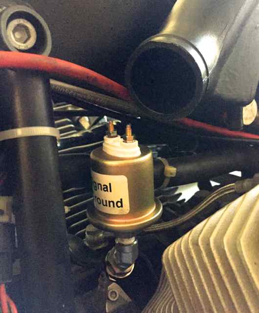

Here's how I mounted the oil pressure sender unit that comes with the Speedhut oil pressure gauge. The thing is huge - so big that I called to ask if they had a smaller one (they don't and they said this is the only one compatible with their gauge.)  After much experimentation and thinking about how to relocate it to the frame (where the fuel filter or pump are on pre 2003 models), I hit on this:
To block:  Washer and metric 12 x 1.5 male to 1/8 NPT female adapter - available from Speedhut in brass or steel, I used steel.
Adapter to Sender unit:  45 degree elbow, 1/8 NPT male to 1/8 NPT female (also steel)
The sender unit has two electrical studs, one for the signal and the other for ground. The ground is not needed if you use teflon thread sealing compound (brush-on) instead of teflon tape. I tested and got 0 resistance between the ground terminal on the sender unit and the negative terminal of the battery. So just one wire is needed (from the gauge).
FYI - this would interfere with the rubber snorkels from the airbox, but I already ditched them.

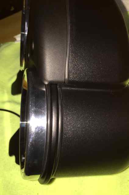

80mm O-rings - 2.5 mm thick between trim ring and dash, 3.5 mm thick between dash and bucket. This takes up about the same space as the stock rubber gasket did around the ITI gauges - and allows the little rubber gasket at top of warning lights to align correctly.

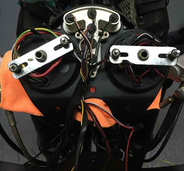

Here's how all the wires and brackets aligned to fit the cup. I didn't put the inverter or the fuse inside the cups; still need to do some cable management.

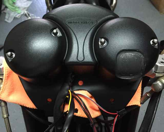

Here's the stock cup all fastened up. I cut a section out of a black pvc pipe elbow and glued it to the inside of the bucket with black RTV. I was a little messier than intended, so I just smeared the whole thing. Can't see it anyway.

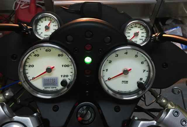

And here's the rider's-eye view of all four gauges.

I put the LeMans back together enough to start it and ride around the block. Mostly spurred by a concern about the oil pressure sender.
Oil Gauge:
When I connected the oil pressure gauge signal wire to the signal terminal and turned the key on, the gauge registered 25psi. So I thought - "Wow, That's Fantastic (aka WTF?), I've got oil pressure and the bike's not even running." I contacted Speedhut, and apparently this sender sometimes doesn't get set correctly at the factory. They offered to send me a new one if it didn't test out. The good news is that the pressure increased a lot with the bike running, but it did not settle back to 0; it still went to 25psi, and this is not because of the stepper motor, it always goes to 25. Therefore, new sender unit is needed. I also learned that Speedhut can (for about $80 extra) convert the gauge to their next level up, which is somehow better, but looks the same, and also uses a smaller sender unit. I'll pass for now and see if I can get their entry-level gauge working correctly.
Voltmeter:
Seems to be working well. Registers a bit under 12 with key on, and increases as expected with the engine running, and a bit more at higher revs.
Speedo:
Works fine with the GPS sensor underneath the fairing and at a pretty steep angle (between oil and volt gauges, stuck to inner dash panel with foam adhesive tape).
Tach:
Also works - but needs to be calibrated for a 2-cylinder engine pulse. I think it's reading half-speed as though it's measuring a 4-cylinder engine.
FYI - Speedhut can put new faces in their gauges for $30 each if you send them in. So if you want a different color, logo, etc., it's easy to do.
