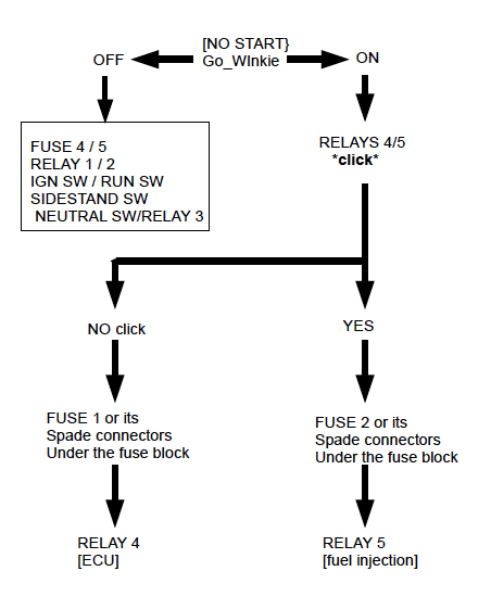

After a recent "NO Start" experience from adding the 30 amp circuit breaker and moving the Fuse Block around (displacing the lower spade connectors to Fuses 1 and 2), I got a better understanding how to use the Go_Winkie (power indicator from Fuse 8) . . .
Lower (hidden) spade connectors beneath Fuse#1 and #2 for the ECU and Fuel/Ignition relays #4 and #5:

In truth, the troubleshooting flow chart starts with : 12v to Fuse 8
That's where my *Indicator light* is wired. (The former Electric Petcock connector)

Lately, the Sport does not fire-up every time, at the push of a button (the Start Button).  Cycling the Run Switch a few times gets things going. I noticed the Go_Winkie is not lit when the >No Start
Good news: It is not the injectors, coils, ECU, fuel pump, Fuses 1 or 2, the "secondary/hidden" spade connections underneath Fuses 1 and 2, Relays 4 or 5, or any of that independent wiring harness for ignition/fueling.
Many thanks to  :notworthy:  Kiwi_Roy for this simple and effective real time, onboard diagnostic tool! :thumbsup:
Embarking, now, on the fault. Beginning with opening, cleaning, and DeOxit for the Run Switch itself . . .
Link to comment
Share on other sites
After cleaning, and DeOxit® treating the Run Switch (and Start Button), the Go_Winkie illuminates every time.

Cleaning/DeOxit® of the Run Switch solved my intermittent no start that was accompanied by simultaneous No-Go_Winkie.
Saved me a boatload of troubleshooting! :thumbsup: :thumbsup:
