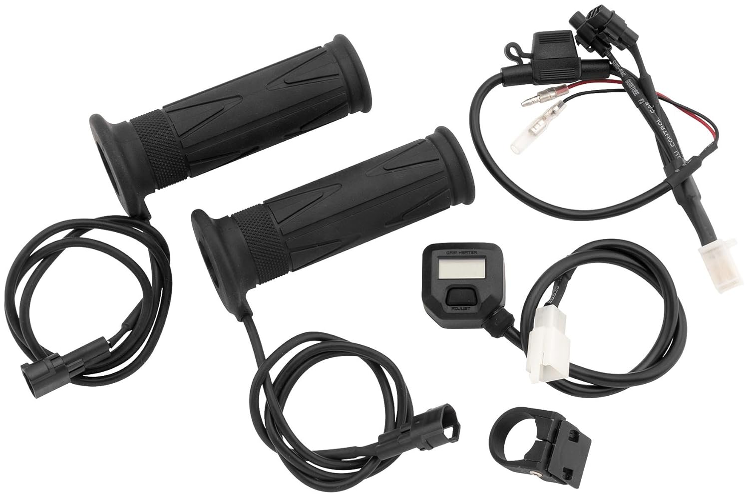

I can't say enough about these Bikemaster Heated Grips. I had the previous generation (no LCD controller, just LED lights) on my Triumph and I also put them on my 850-T. They are super simple to install, and more importantly they work great! The best part of all... the price. Phenomenally low price for something that works this well!
Why heated grips? Just a little warmth on a cool day goes a long way. While they won't heat your hands up on a frigid sub-freezing, high speed ride, they will take the edge off.
Here in the PNW, we have more cool days than warm days, and even on some warm days there are cool evenings. And for this price you can't go wrong.
Throw in a free volt meter? Shut up!
Needless to say, they will be going on my V11.

So for my birthday I got the grips. It's like she reads my mind!
I'm thinking the controller will go right here. Unlike the old ones you want to be able to clearly see it if you want to view the voltage.
These grips seem to put up more of a fight than other bikes. Let's see how they respond to some compressed air.
Then it's just a matter of wiring it up. Positive to a keyed source and ground for the other wire. Run wires and zip tie. More later.

I shaved down the light ridges on the throttle tube.
The throttle side needed some light encouragement. But it also won't slip.
The clutch side was a little lose. I put some silicone but it doesn't seem to be holding yet.
All the wiring is ran but I still don't know where to tap the power from. I need a keyed source and only 5 amps, the grips pull 4 amps max. It's not uncommon to pull from a brake light line or something like that. Plus with the LED brake light now there's very little load on that circuit.
Thoughts? Where have people pulled auxiliary power from?
