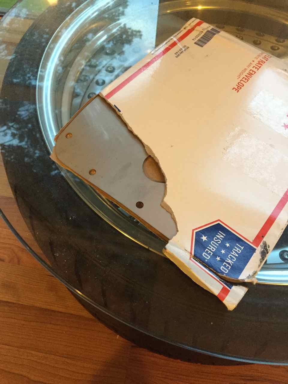

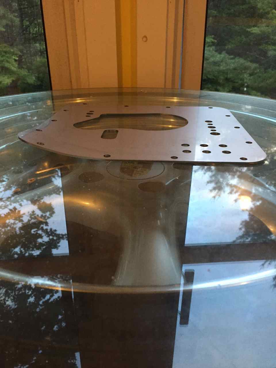

Here is Kostarica's Tonti plate. The poor thing appears to have been run over in Crosstown Traffic, like Jimi Hendrix sung: "Tire tracks all across your back, I can see you had your fun."  I really like the irony of what I assume to be a tire track and how it goes right over the "Tracked *** Insured" promise on the package.
Kosta was going to try to get it pressed flat by a machinist - I'm not sure if that will work well enough.

Thanks Pete, I could have covered it if it was a V11 plate, but it was a Tonti, and I don't have an extra. I sent you an e-mail with shipping address.
No worries, I'll flick another one off tomorrow direct. With that one I suggest beat the f*cker flat and use it in something else :D

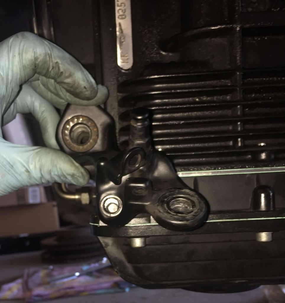

Here is the alignment problem that the Roper Plate creates. A few minutes with a round file or a small grinding tool will take care of it. Elongate the lower hole so you will not bend the small, lower bolt when you torque down the large, top bolt.

Hi scud. Can you elaborate on this issue a bit more. Thanks!!
The sidestand bracket has two mounting holes.
  1. Upper: large hole for the large bolt that goes into the timing cover.
  2. Lower: smaller hole for a smaller bolt that goes into the upper oil sump ring.
The plate, when installed, moves the upper sump ring down, by the thickness of the plate and one extra gasket. This causes a misalignment of the hole in the sidestand plate and the threads in the upper sump ring. Notice the brightest hole in the above picture and how the circles are not concentric. You need to elongate the lower hole (downward) so the bolt has a straight approach, through the bracket, into the threads in the upper ring.
It will make sense when you have it your hands. I think this is the only "trick" to installation, unless you count this as a trick: raise the parts and gaskets toward the engine with two opposite-corner bolts sticking through to keep everything aligned.
