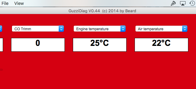

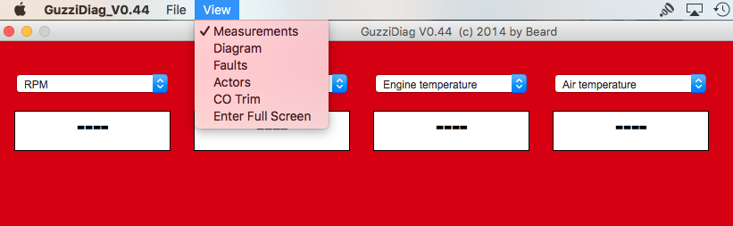

Once connected, select from "View" : *measurements* and select the sensors you want to monitor. I am most concerned about CO Fuel Trim, RPM, Engine and Air Temperatures:   If your CO Fuel Trim is
Posted Images
If your CO Fuel Trim is in the negative double digits, your V11 will never run right.

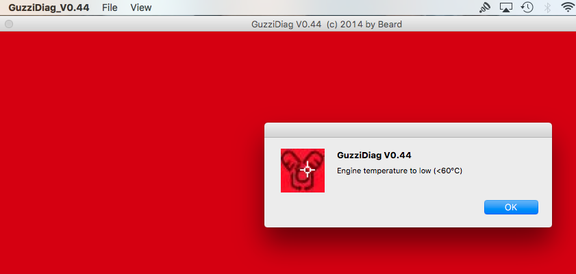

The engine will have to be to minimum operating temperature (60ºC) to set the CO Fuel Trim by clicking on "View" and selecting CO Fuel Trim (guzzidiag will prompt you while you monitor engine temperature (I like using a fan over the front):
