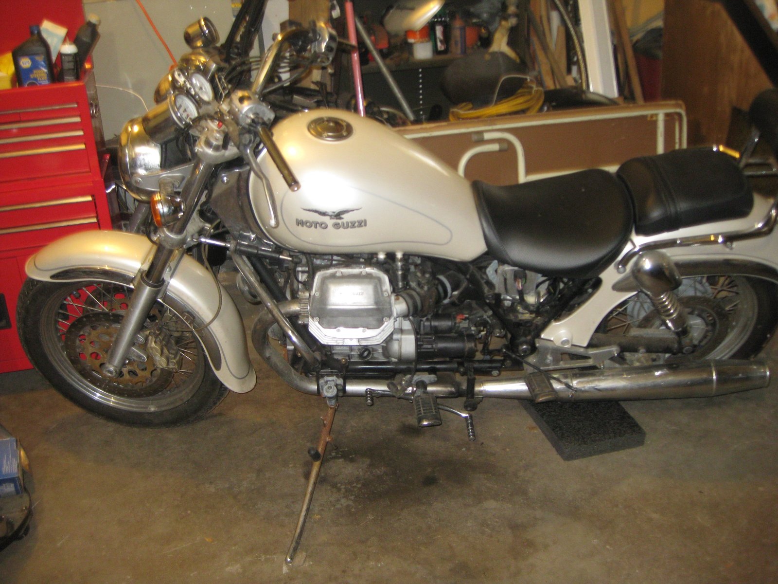

I still don't know for sure he is talking about a VII or something else, we don't have the obligatory picture, LOL
So it turns out to be a VII Bassa at least that's what it says on the side cover, beautuful mile muncher, the EVs had foot boards, I prefer the pegs and love those tubeless wheels, a classic Guzzi for sure.

I see the picture

Looking at the gallery post methinks gatorman has a California not a V11.   :not:
Haha . . . well there is that! :blush:

Gatorman   hope the picture posts in my gallery
Yeah, man. Looks like a nice pearl white V11 EV?
All my comments were applicable to a 2001 V11 Sport or Rosso Mandello. The EV has a different (5 speed) gearbox and different flywheel from the V11 Sport, so none of my replies are likely going to be helpful.
