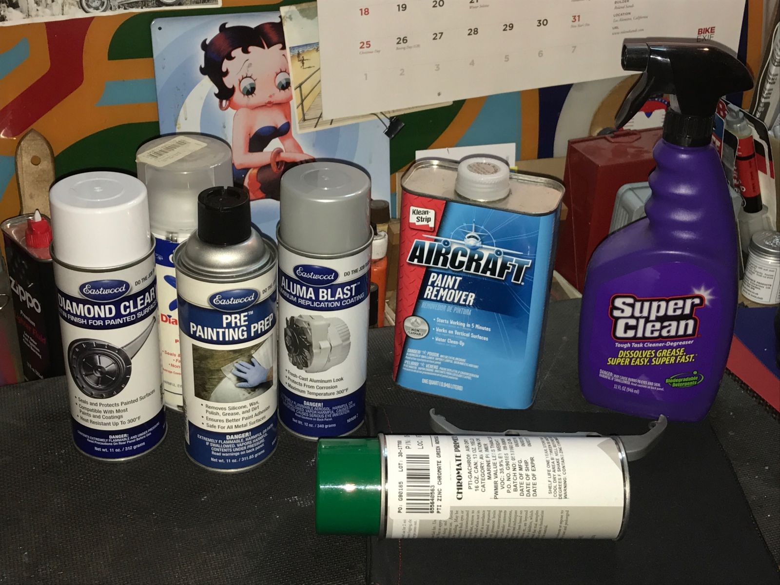

Just back from the auto parts store where I do a lot of business. Sometimes, it's good to cheer folks up . . .
"What d'ya need today, docc?" :nerd:
"I'm here to pick up a stripper. . ." B)
(We got to the "aircraft" part when the howling settled down. :rolleyes:
What are you planning to strip Docc? If it is your fairing, is it metal or fibreglass?
Stripping metal is fine, but some strippers are just as good at eating resin as paint. You should take care stripping any composite fairing. If the stripper attacks resin, you can be left with a spongy mess of bleached fibre matting. Maybe you could test a hidden spot on the fairing.

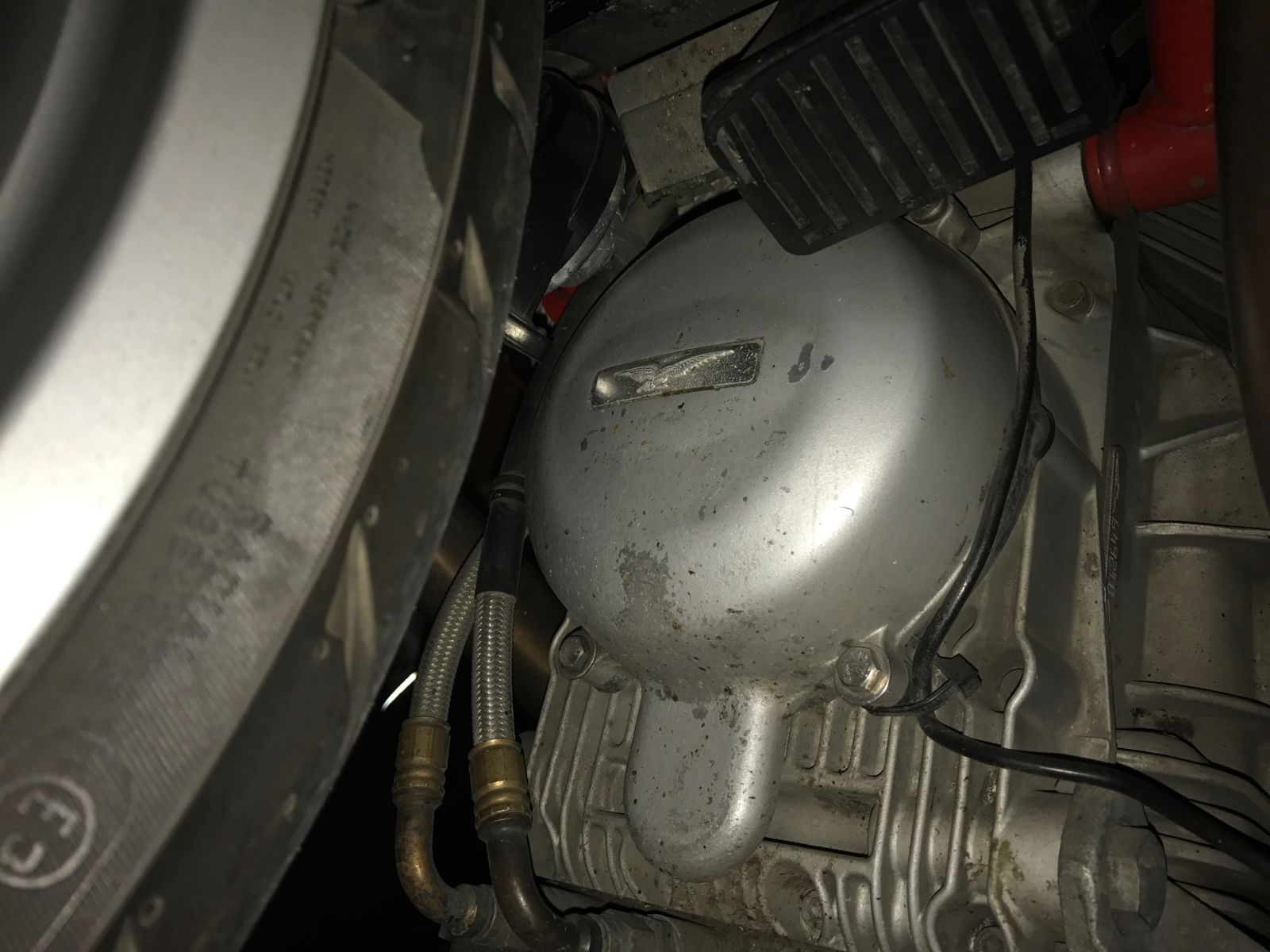

Only the alternator cover!   It's not *bad* (I've refinished it twice), but could use a good re-do. I think it will be pretty subtle, down there, in this *satin-green*.
I've never thought of doing it in anything but silver or maybe carbon fiber, so this Carcano-ZnCrO4  is going out on a bit of a limb for me.
Sometimes, late at night, I can see doing (in zinc chromate green) the entire Stucchi (fiberglass) bikini fairing, front fender, a (number-plate) section on the leading edges of the tank, and even the leading edges of the valve covers . . .  :mg:
That seems pretty radical, so not yet, though! :o
For now, I'm just more concerned I'll mess up the the "Eagle badge" on the alternator cover. Can I mask it off or should remove it for the "refinish?"

If you're going to use stripper, it will probably migrate to the adhesive or the chrome on that little eagle.  So I'd suggest removing it, which is easy to do. Heat the inside of the cover behind the badge and pry it off gently. I reattached mine with 3M double-sided adhesive foam tape - just cut it a little smaller than the eagle. It's still holding.

This Eagle badge is listed as GU02517700 "adhesive label" in the parts manual. If your badge is grit blasted into an unrecognizable mess like mine is, you could replace it. Brace yourself for the price though.

Thats not a stainless bolt holding that cover on is it docc?
Looking good though for a 100,000 mile motorcycle
Guilty. :blush: . . . . I'd like to think they have a proper coat of copper antisieze on their threads. The top two are still the original cross-head screws. Not sure why.
She has a few *character lines* now, the old girl . . .  -_-
