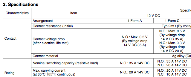

Since only the #1 ("Starter") relay uses both outputs (5-pin/ SPDT/ Form C), this is the Panasonic 5-pin the "1 FORM C" contact arrangement.  [also known as a CO ("change over" contact arrangement) showing both NO and NC ratings]
I'm trying to discern what part of the Panasonic relay is only rated for 10 amps continuous?
edit: [Answer: the NC contact which would not be good for Relay#1 in the early V11.]
Panasonic spec sheet:

I don't know why one side of a relay would be rated for less currant than the other side. One thing to remember is that a relay is just a two position set of contacts that is controlled by a separate power feed. When no power is applied to the control circuit the relay bridges the controlled feed to the NC (Normally Closed) contact. Apply power and the relay switches to bridge the controlled feed over to the NO (Normally Open) contact. NO and NC do not refer to the normal running state of the contact but only to the state of the relay when power is not applied to the control circuit of the relay. Why that NC contact would be rated for less amps than the NO contact is surprising to me but I assume it is because that side of the relay is not built as heavy duty.
I am no electrical engineer, but I do work with relays and control logic. I defer to Roy whenever possible on electrical things. I assume he will be along shortly to explain what I don't understand.

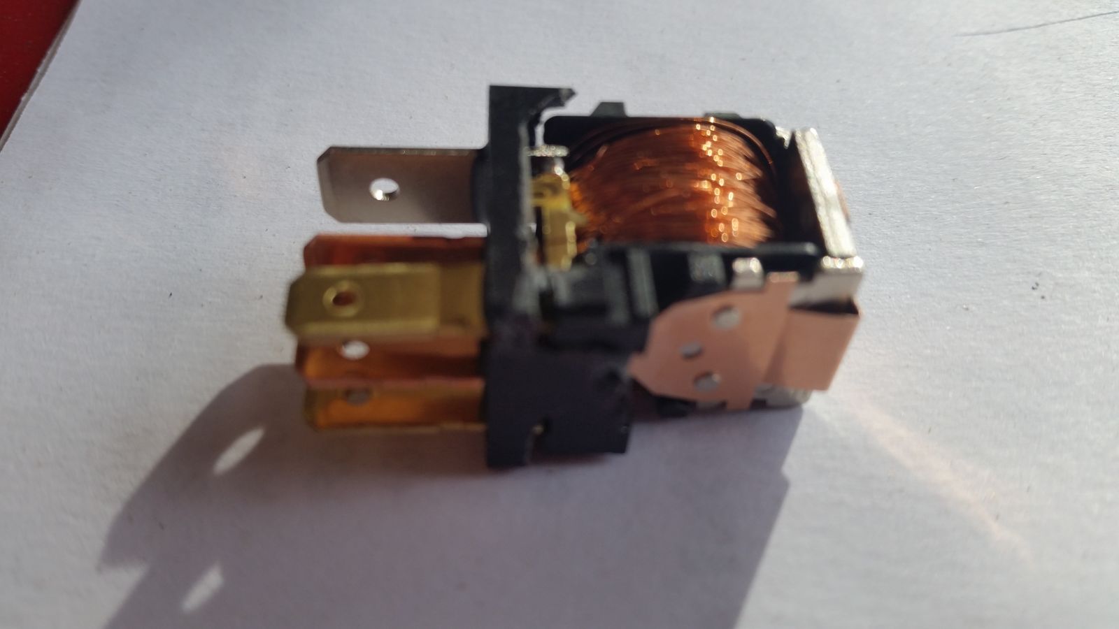

Docc,
Since I had an extra and "Inquiring mind need to know" I hacked one open so you could compare to historic data. It's well sealed is made of high quality components. Apologies for the pic quality as the phone is not the best suited for close up photography. I also cut a few winding's in the process.

I knew you guys would come through! "NC" and "NO" make perfect sense now, along with why their ratings differ. And now: a  :notworthy:  sacrificial relay!
If I understand correctly, (on early V11), the 10 amp NC contacts are carrying the current through Relay #1 ("Starter" Relay) to power the 20 amp NO contacts in Relay #2 ("Headlight" relay) which includes the headlamp, horns, warning lights, brake light, tachometer, and charging reference.
**[EDIT: This is only the case with a *Stressed* Relay#1. Do the Easy Livin' Test to see if your Relay #1 is Stressed :blink: , or Livin' Easy :rasta: ]**
(I realize the vendor says the Panasonic is 20amp/35amp, but that is the "swtiching"  rating, not the continuous current rating: 10a NC/20a NO continuous)

Here is the spec sheet on this relay. It appears to have significantly higher ratings including 20 amps continuous carry current on the Normally Closed side (35 amps continuous on the NO side, and MUCH higher inrush ratings). This is the most robust micro relay I have seen specs on.
http://www.omron.com/ecb/products/pdf/en-g8he.pdf
It looks to have very slightly larger case dimensions, including 1.6mm taller, so make sure your seat has the clearance for them:
https://www.omron.com/ecb/products/search/?cat=1&did=6&prd=auto-iso&lang=en

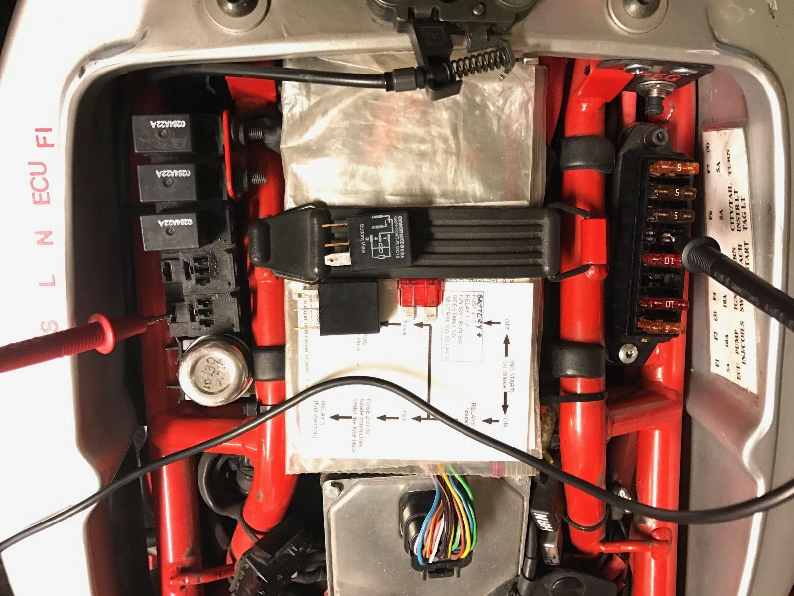

"Livin' Easy Test"
(for Relay #1):
*If* your #1 Starter Relay is "livin' easy" :rasta: , the only really stressed relay is  #5   [Fuel injection/ignition/fuel pump relay in Position #5 moves over 20 amps in the NO position]. Use a serious relay in Position #5, rated over 20 amps NO >Continuous Carry Current<. [ OMRON G8HE-1C7T-R-DC12 ]
#2 (headlights etc) isn't getting off particularly easy, but any any "high quality"  :rolleyes:  relay rated 20 amps NO should do okay there.
Here's an easy way to see if your (later V11) Relay#1 is livin' easy :rasta: :
Pull Fuse 5, and Relay #1. With an Ohm meter, check continuity between the Fuse connector (outboard) and contact 30 for the relay (also outboard).
Failed test = continuity. You have the *stressed*  :blink: #1 Relay moving over 10 amps through the NC contacts >Continuous Carry Current<. Use a High Current Relay in Position #1 (rated over 10 amps in the NC position). [ High Current OMRON G8HE-1C7T-R-DC12 ]
If Fuse 5 is continuous to Relay#2/contact 30 (outboard) instead, your #1 Relay is livin' easy  :rasta: but you're starting the V11 through the Ignition Switch :unsure: (Beware of "Startus Interruptus", plus the Ignition Switch should always be cleaned and kept serviced, regardless):

Please do this simple *easy livin' test:rasta:  (continuity from Fuse5 to Relay#1) on your V11 and post results , and let's see if we can nail down where the wiring may be different or may have changed.
