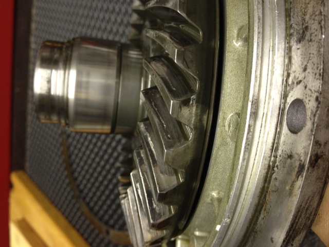

andy york Posted February 17, 2017 Share Posted February 17, 2017 Had a small weeping (annoying) rear diff leak. pull it all apart, fixed it. What the pictures show me is that the deterioration has not gotten any worse. Granted, I found this wit about 30k on the bike. Had it all Micropolished, and still going strong. Link to comment Share on other sites More sharing options...
andy york Posted February 17, 2017 Author Share Posted February 17, 2017 maybe now Link to comment Share on other sites More sharing options...
andy york Posted February 17, 2017 Author Share Posted February 17, 2017 have to look close to see it. been that way for about 90k. never find any material in the oil when I change it. I'll keep on riding . andy 1 Link to comment Share on other sites More sharing options...
Lucky Phil Posted February 17, 2017 Share Posted February 17, 2017 The problem is Andy with gear face wear that bad the issue will be a fatigue crack in one of the teeth that will eventually break off. For safety reasons I'd rather not be the one riding it when that happens. Ciao Link to comment Share on other sites More sharing options...
andy york Posted February 17, 2017 Author Share Posted February 17, 2017 I honestly think it left the factory that way.I may have been a little vague. I first noticed this,oh ,say, 2003... when I had my first weeping of the rear drive. Upon disassembly,that is what I discovered. And that was probably 80 to 90 k ago. no metal or swarf in lube....ever. I did reset the gear depth a bit back then. Not trying to push my luck, I just always find it amazing how "bad" something can be mechanically and still function andy 1 Link to comment Share on other sites More sharing options...
Lucky Phil Posted February 17, 2017 Share Posted February 17, 2017 I honestly think it left the factory that way.I may have been a little vague. I first noticed this,oh ,say, 2003... when I had my first weeping of the rear drive. Upon disassembly,that is what I discovered. And that was probably 80 to 90 k ago. no metal or swarf in lube....ever. I did reset the gear depth a bit back then. Not trying to push my luck, I just always find it amazing how "bad" something can be mechanically and still function andy Wow that is amazing. Always good to know what you can "get away with". Ciao 1 Link to comment Share on other sites More sharing options...
andy york Posted February 17, 2017 Author Share Posted February 17, 2017 And I really was not trying to be cynical about it. I will be the first in line to say something doesn't look right or should not be done. I will say that 14 years ago I did not have an extra grand laying around to buy a new ring and pinion set. I also never thought of breaking a tooth off. andy Link to comment Share on other sites More sharing options...
