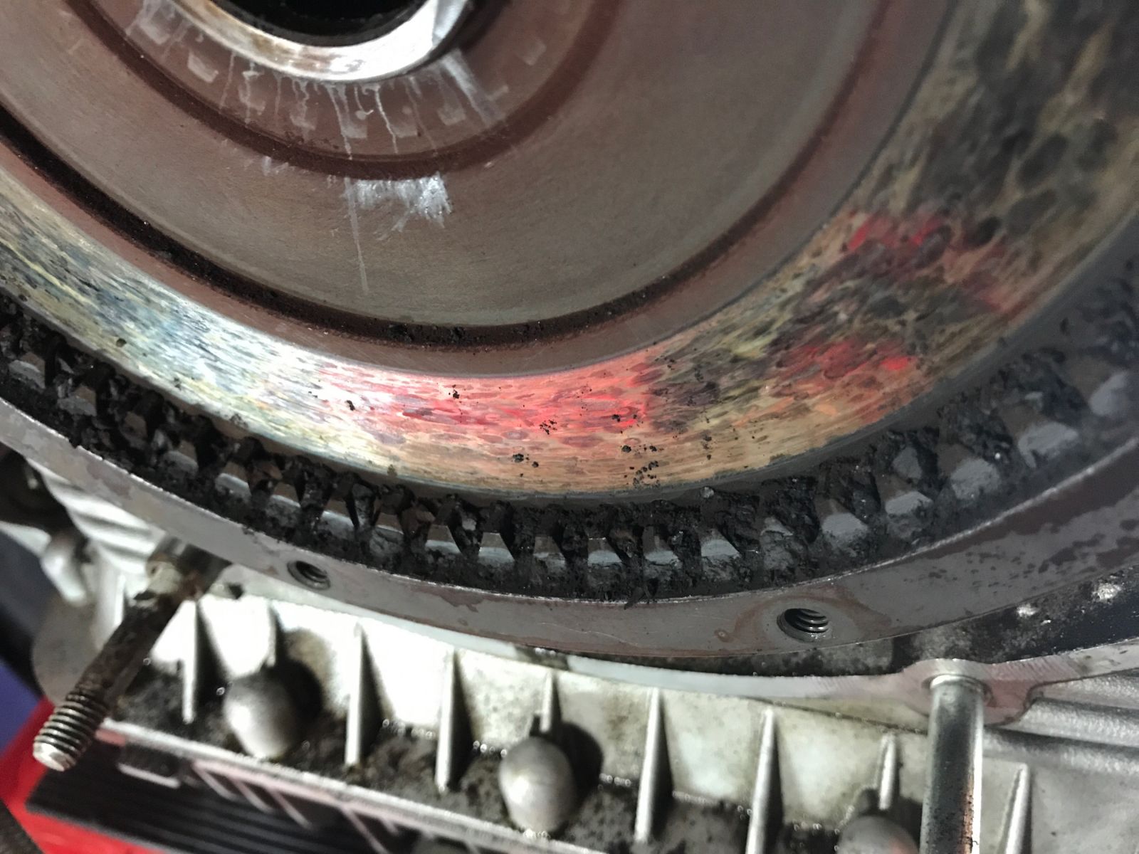

So, the flywheel surely shows significant wear, but that isn't what was making the extra noise:
There was certainly enough worn friction material and just enough oil leak to gum up the movement of the plates, especially the intermediate:
And these unfortunate surfaces to consider:
The noise was very likely the loose input hub. We found it completely loose and rattling around. The retention washer had failed to retain the input hub on the gearbox input shaft and it had backed all the way off. I guess it just didn't have quite enough room to fall off. :o

Yes...  that is some nasty... but, if the input hub was loose, that was the problem...everything else is secondary.
