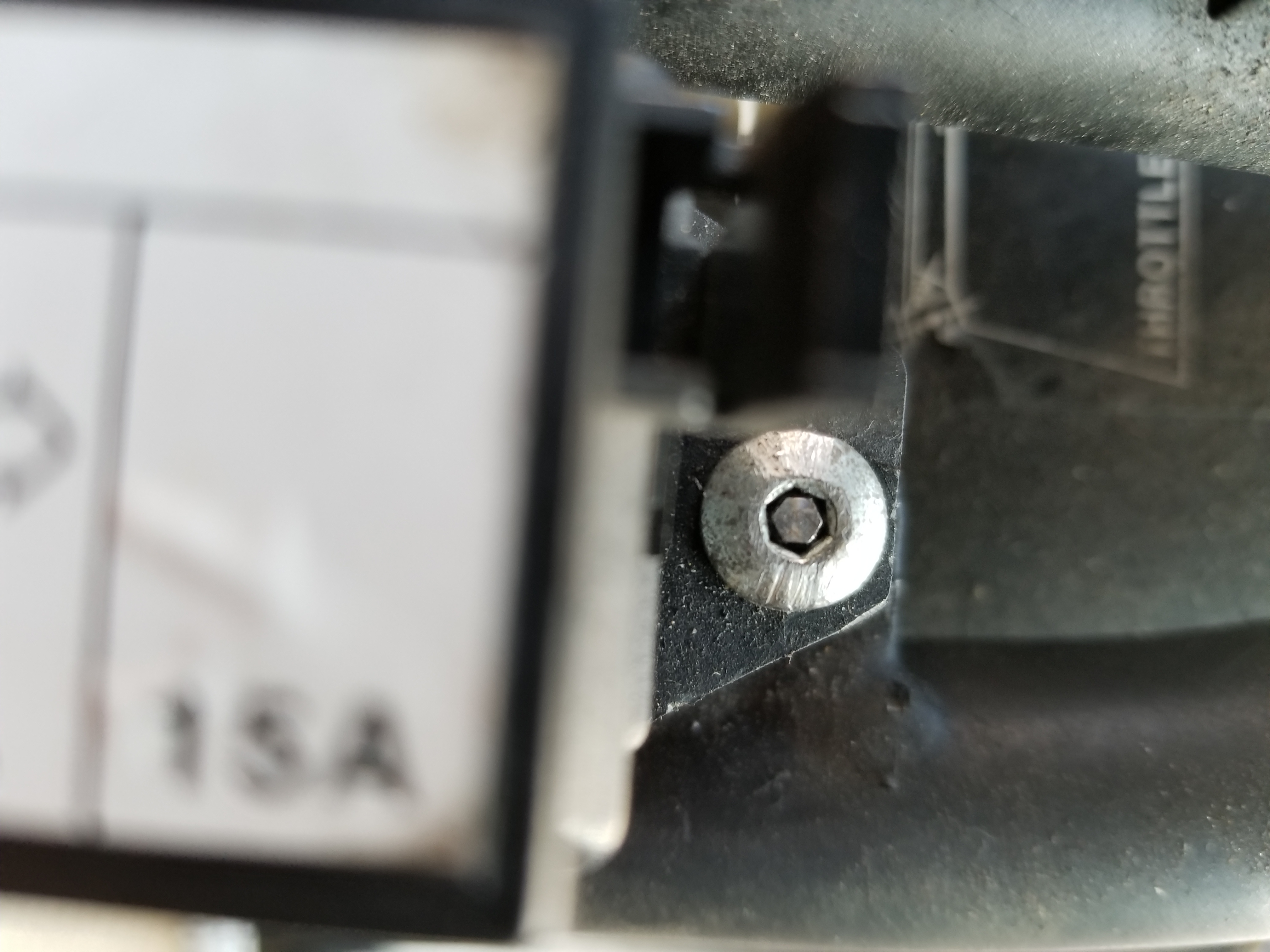

Yep, that's a bit too small hex key jammed into the bolt head, then sheared off after it wedged in.  This is the rear bolt holding the fuse block. Fortunately, the bolt had just enough shoulder to get a vice grip on it and remove.

The irony here, of course, is that you don't even need to undo that. The fuse bloc just pops in and out without tools.

Well, it would pop in and out if the PO hadn't also removed the rubber plug and standoff and replaced them with what looked like the captive square nuts inside of battery posts then nutted the other side.  Maybe he was worried the fuses would vibrate out?
Hahaha... enjoy.
I have an old wiring harness. I can check to see if the original fasteners are still on the fuse block.
