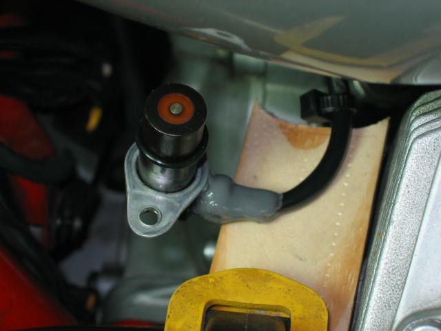

the '02 started dripping onto the xover 3 years years ago. it was a disintegrating case/frame vent tube. the '00 I just got into my life is doing the same. It's SO obviously a rotten vent tube, again, onto the xover. The '02 also leaked from the timing sensor. None of the leaks made it to the floor.

Ive had several. Timing cover gasket, front crank seal, timing sensor (a few times), crank vent tube, rear drive seal (fingers crossed the big outside one will hold) and the one I haven’t got yet is the rear transmission not a gasket housing.

Timing gasket leak, poss weeping from the crank sensor hole, and poss one other as yet undiagnosed....

Ten year thread "Oil leak " on leaks up front: timing chest, timing sensor (#112 O-ring), and even the wire lead from the timing sensor:
