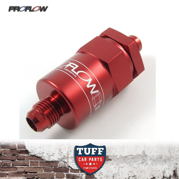

Thanks for the suggestions but they're a bit bigger than I was considering. I'm going to go with this and a pair of 90 degree AN-6 5/16 barb fittings.
55mm long and 32mm dia.

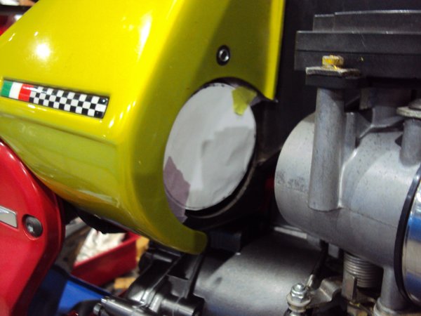

I totally forgot about the engine offset effect on the airbox position in the frame, thanks for that info.
The 10mm misalignment is the vertical alignment not the horizontal.
So as far as I can see with the centy engine in the frame with the centy inlet trumpets and the V11 airbox fitted the airbox trumpet holes are going to need to be raised around 10mm. The V11 airbox holes are also a little smaller than the centy airbox holes due to the centy trumpets being larger in diameter than the V11. So the airbox holes need to be 10mm higher and around 5mm larger in diameter with the engine fitted with centy inlet manifolds(alloy manifolds bolted to the head) centy throttle bodies and centy plastic inlet trumpets. If there is some other combination of inlet manifolds and or trumpets that will mean I dont need to raise the holes in the V11 airbox it would be great to know. Opening up the airbox holes diameter by 5mm is easy but also raising them 10mm is tricky and will require plastic welding.
Here's an image of the installation Paul to give you a better understanding of the issue. I've cut a paper disk the size and position of the hole required to be in the V11 airbox to mate with the Centy throttle bodies and plastic inlet trumpets and taped it to the V11 airbox. Note the area that will need to be filled with palstic weld from the 3 to 7 oclock position. As far as I can see anyway unless you have info from the others you know that have done the conversion?
It seems some of the 4v/2v conversions also went with pod filters. Not all, but some I have images of. The ones that didnt my images dont have enough resolution to pick the details.

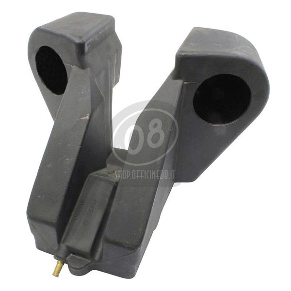

I was using this image of the centy airbox to scale the openings.
