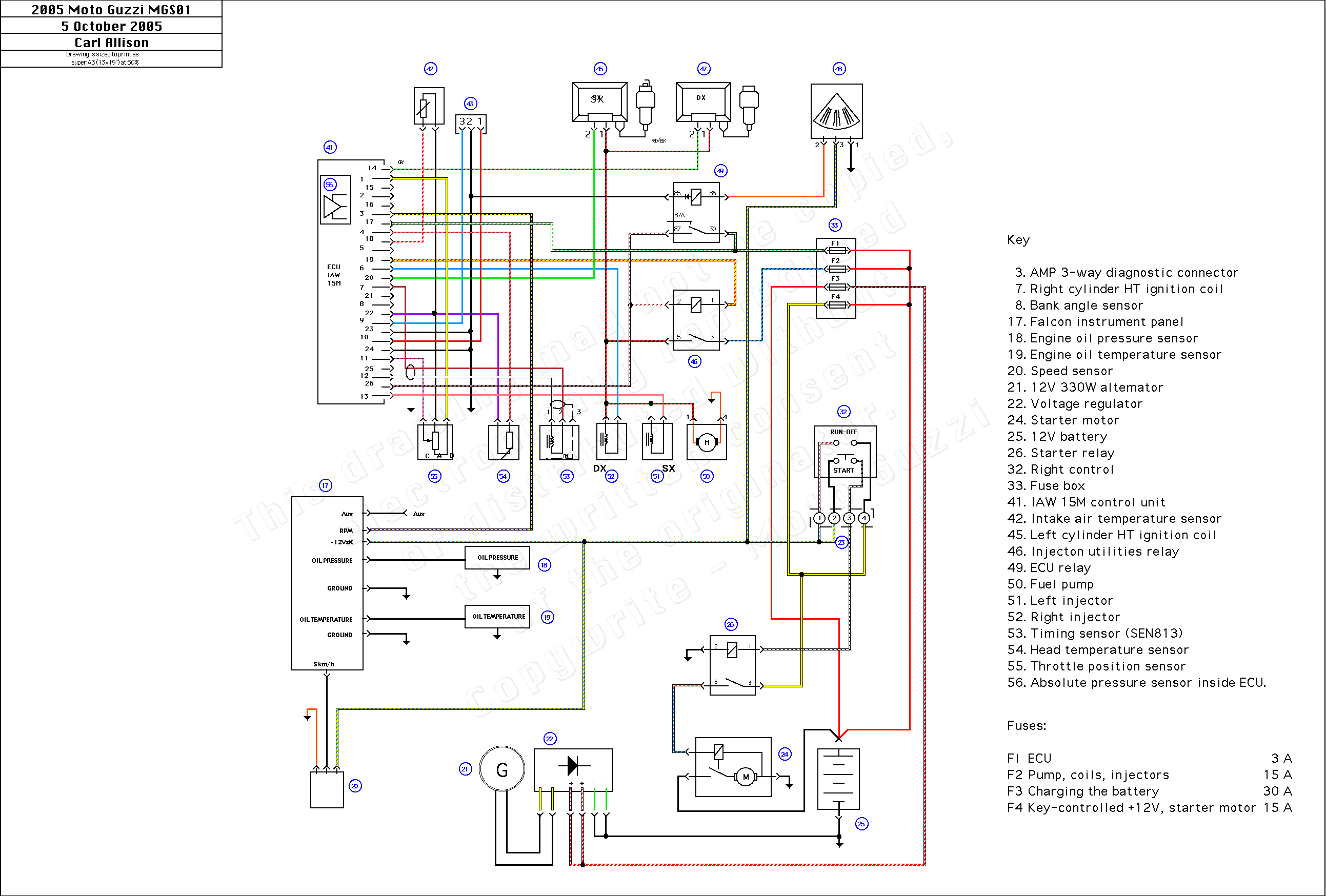

madbunny, would you post pictures of the fuse block and the relay set so we can think of how much this wiring is like the V11?
hi docc
this is MGS-01 wiring diagram.
It is a really simple, because there are no lights or accesory.

Relay 46 and fuse F2 power the injectors and ignition. Apparently, the ecu is ok because you have spark without compression. Can it be as simple as a weak battery? Load test it. If that's not it, I would certainly suspect 46 and F2. Maybe as simple as corroded relay base or fuse connections? Corrosion at any place in that system, including ignition switch?
Getcha a can of DeOxit, go over *everything* electrical, put new plugs in it. If that's not what it is, it's over my head.. good luck.
