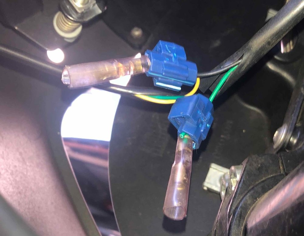

Taxguy 0 Posted August 4, 2019 Author Report Share Posted August 4, 2019 Thanks Docc. It appears that a previous owner has already addressed this issue. Turning the bars didn't make a difference. Quote Link to post Share on other sites
docc 3,762 Posted August 4, 2019 Report Share Posted August 4, 2019 So, those Scotch Locks are to eliminate the bullet connectors? Might as well take them apart and make more secure connections (Lap splice, crimp connectors, etc.) and seal them well against the weather and blow. Those connections could still be problematic. Lights come on? Horn? (Edging toward relays next . . . .) 1 Quote Link to post Share on other sites

Chuck 1,529 Posted August 4, 2019 Report Share Posted August 4, 2019 1 hour ago, Taxguy said: Thanks Docc. It appears that a previous owner has already addressed this issue. Turning the bars didn't make a difference. Eewww, that's ugly. That's *not* an airworthy connection. 1 1 Quote Link to post Share on other sites
Tomchri 371 Posted August 4, 2019 Report Share Posted August 4, 2019 1 hour ago, Taxguy said: Thanks Docc. It appears that a previous owner has already addressed this issue. Turning the bars didn't make a difference. And it seems to have been hot already,, greenish melting plastic. Cheers tom. Quote Link to post Share on other sites

gstallons 791 Posted August 5, 2019 Report Share Posted August 5, 2019 2 hours ago, Tomchri said: And it seems to have been hot already,, greenish melting plastic. Cheers tom. ScotchLock connectors are all time $hit . Quote Link to post Share on other sites
