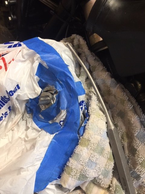

No 5 spiral bolt extractor gave up after I put an old fork leg on it for 3/4 of a turn... ground a nice flat on the plug to give some good smacks, then the plug split. Now I’m getting nervous

What is that ? The Weather Channel reporting on this stuff off Florida ?

wish I could see it better. Is that the plug with a hole drilled in and a broken easyout protruding? In different circumstances of course, I've then removed the easyout and continued drilling with larger bits till I almost reach the female threads... then pick away at whats left till I can get a clean-up tap in. I learned that technique once while having a wisdom tooth removed at the dental school.

Sorry, Docc will tell you I’m no photographer. Yes you are right that’s a broken no5 easy out and the outer rim of the plug is breaking away. These don’t have loc-tite on them?

hopefully the easyout comes out easy. then if enlarging the hole VERY carefully won't work, use a die grinder or dremmel tool with grinder bit to hollow it out. just don't get into the female threads.

Again, weld a nut to the sheared off easy-out and remove it. I cannot see which type you are using, I do not like the left hand thread tapered type, as you screw them in they squeeze the nut/bolt out making it even tighter in the casting. Go too far and you will crack the casting. There are parallel easy outs that work well with the correct drill but once they slip you have to go up a size.
I feel attempting to drill, grind and then picking out the remaining thread should be you last idea as you will find it very difficult to drill central and square. You could well end up using a thread insert but that opens up difficulties with making it oil tight as you may encroach on the o'ring.
Of course removing the head allows you to get to a machine shop for a professional repair, at a cost.
Please try the welding a steel nut on first, it really does work and is cheap.
