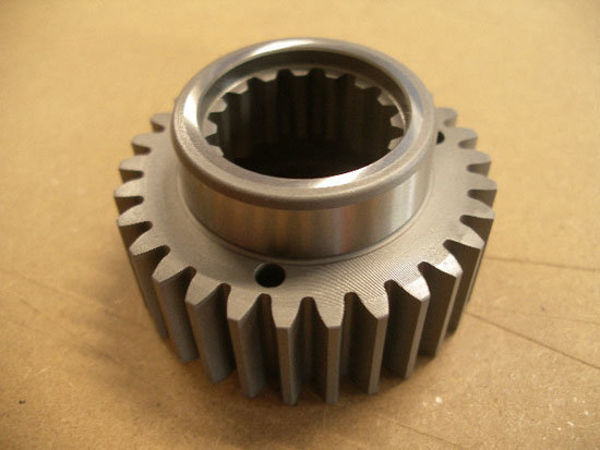

Chuck Posted December 20, 2019 Share Posted December 20, 2019 My friend Mark at MG Classics, has a customer with a dead Scura. When I came through the door, he said.."here's the guy that will know.." He was wrong, of course. I told him that I thought Ram made a single plate kit if you have the original input gear. It does, but it's toast, too. Mark can't find one. What is involved in installing a dual plate clutch? Parts availabity? TIA Link to comment Share on other sites More sharing options...

Chuck Posted December 21, 2019 Author Share Posted December 21, 2019 I should mention that Mark has a 98 V11 twin plate clutch available. What does it take to make this usable? Link to comment Share on other sites More sharing options...
pete roper Posted December 21, 2019 Share Posted December 21, 2019 (edited) Swapping out the gearbox input boss is the only other thing you need to do. From memory the boss for the twin plater used on the V11 has a shorter spigot, (The bit the seal runs on.) than the one for either the five speed box or the later six speed used on the CARC bikes. I'd just make sure you check the part #'s to ensure you get the right one. Other than that it's a straight swap. My personal and entirely unsolicited opinion is that the difference in performance between the grenade like factory single plater, it's aftermarket cousin and the tried and tested twin plater that had been used in eight and ten spring form since pterodactyls were laying eggs is so negligible that especially on a street bike the risk/cost benefit analysis makes the twin plater a far better option. That's why the Scura RC has one in, (Along with the stock airbox, filter etc.) Pete Edited December 21, 2019 by pete roper Spelling. Link to comment Share on other sites More sharing options...
Lucky Phil Posted December 21, 2019 Share Posted December 21, 2019 1 hour ago, Chuck said: I don't think I understand what you're saying Phil..can you try me again? I don't have either in my hand and my memory is not terribly long. 🤔 The only difference I can see between the twin plate and single plate gearbox input spline drive that bolts to the gearbox input shaft is the depth (front to back dimension) twin plate looks like maybe 25mm of spline that interfaces with the clutch friction plates and the single plater maybe 20mm. So why not just surface grind that additional 5mm off the fwd face and bring the splined length fwd to aft doen to the single plate dimension. If it was softer material you could just chuck it up in the lathe and face it off but it will be too hard for that. Ciao Link to comment Share on other sites More sharing options...
Lucky Phil Posted December 21, 2019 Share Posted December 21, 2019 29 minutes ago, pete roper said: Swapping out the gearbox input boss is the only other thing you need to do. From memory the boss for the twin plater used on the V11 has a shorter spigot, (The bit the seal runs on.) than the one for either the five speed box or the later six speed used on the CARC bikes. I'd just make sure you check the part #'s to ensure you get the right one. Other than that it's a straight swap. My personal and entirely unsolicited opinion is that the difference in performance between the grenade like factory single plater, it's aftermarket cousin and the tried and tested twin plater that had been used in eight and ten spring form since pterodactyls were laying eggs is so negligible that especially on a street bike the risk/cost benefit analysis makes the twin plater a far better option. That's why the Scura RC has one in, (Along with the stock airbox, filter etc.) Pete I didnt remove mine from the gearbox Pete but it looks like its the same as the single plater and I cant see any reason for it to be different. Famous last words of course. To me it looks like the single plater is just a shorter version of the twin with all the material taken off the front face. Ciao Link to comment Share on other sites More sharing options...

Scud Posted December 21, 2019 Share Posted December 21, 2019 Chuck - I have a spare input hub for a single-plate clutch. I would loan it to you for use as a reference to machine another one down to match, but I think I would not like to sell it. FYI, I ditched my Scura's stock single plate clutch in favor of the Ram single plate with the steel (not aluminum) flywheel. At the time, I had two V11s, one with the standard dual plate clutch. The difference was enough for me to enjoy and appreciate - partly because I like unusual stuff. In terms of absolute performance, the difference is not really material. But a single plate clutch is cool and different... just like me. 1 Link to comment Share on other sites More sharing options...
pete roper Posted December 21, 2019 Share Posted December 21, 2019 1 hour ago, Lucky Phil said: Here's a twin plate 6 speed assy. the single plate one looks the same except for the depth of the splined section front to rear. Here's the single plater Ciao Sorry, the point I was trying to make was you can use essentially any clutch/flywheel assembly from virtually any 1100 model but care has to be taken that the correct input hub is used and that the hubs used on both the five speed and the later 'Three Shaft' six speed as used on the pushrod engined CARC bikes won't work on the V11 'Four Shaft' gearbox so if a clutch assembly off say a Breva 1100 is used, while it is identical the input shaft boss, if supplied with the clutch assembly, won't work and will need to have the correct one substituted. Pete Link to comment Share on other sites More sharing options...
Lucky Phil Posted December 21, 2019 Share Posted December 21, 2019 6 minutes ago, pete roper said: Sorry, the point I was trying to make was you can use essentially any clutch/flywheel assembly from virtually any 1100 model but care has to be taken that the correct input hub is used and that the hubs used on both the five speed and the later 'Three Shaft' six speed as used on the pushrod engined CARC bikes won't work on the V11 'Four Shaft' gearbox so if a clutch assembly off say a Breva 1100 is used, while it is identical the input shaft boss, if supplied with the clutch assembly, won't work and will need to have the correct one substituted. Pete Oh OK Pete, I re read your post and see my mistake. Sorry. Ciao Link to comment Share on other sites More sharing options...
