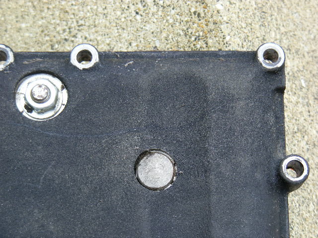

DSCF3155.JPGMarty, thanks for the offer of your plate but hopefully mine is fixable. Here is the crack in my selector plate. What I shall attempt to do is a repair by using a Dremel type tool to open up the crack and then a JB Weld product something like their SteelStik to fill the crack.The plate's top edge is not cracked. Suggestions as to whether I am on the right track or not would be greatly appreciated. What prompted me to remove the plate was a leak for the second time after fitting a new improved selector spring.I used Cyberbond 7518 but this never set probably due to the surfaces not being cleaned properly. I wiped them but didn't use any degreaser solution to remove traces of oil on them. Either that or the sealer was past it used by date, I am  not really sure at all what went wrong.
Rob

If it matters , what are you using as a gasket when you reinstall ? What caused the damage anyway ?
