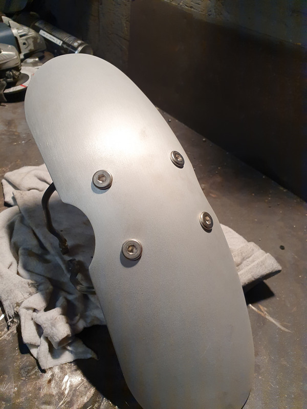

Tinus89 Posted November 16, 2020 Author Share Posted November 16, 2020 (edited) Hi all! I have been FAR too quiet here, apologies for this! I'm checking in with an update on the build, which I should have done more. Apologies. On the carbs, I will have them ultrasonic cleaned in the near future and have bought new choke plungers and a seal kit. I know some people may very much dislike what I have done to her so far, which is OK, but do remind yourself that this started life as a hideous white Florida, so anything is an improvement.... I also have a question. I was thinking about keeping both mudguards in bare/brushed aluminium. How do you keep that looking nice? This is the front mudguard: [ Edited November 16, 2020 by Tinus89 Fixed the pics 1 Link to comment Share on other sites More sharing options...
Emeraldv11 Posted November 16, 2020 Share Posted November 16, 2020 Hi, if you just brush on ACF50 sparcely and wipe the surplus off with a rag it will keep it free of corrosion for a long time. I use it on all my guzzi bare (unpainted) crankcases also for the last 20 years with great success. Good luck with your build, i love the wheels but question the tank,its too bulky to look fast... 1 Link to comment Share on other sites More sharing options...
