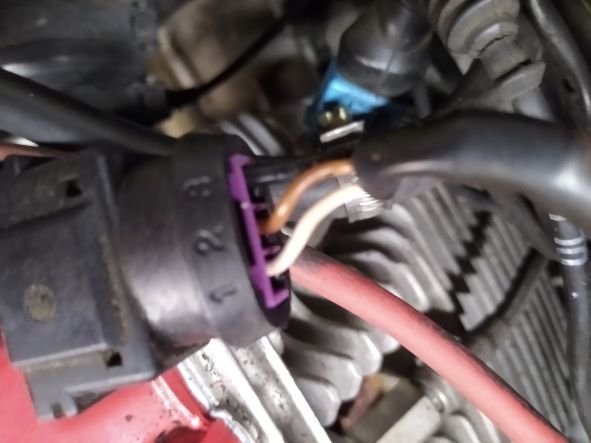

After twenty one years and 80,000 miles it looks like the sensor has given up. There is no resistance between any pins and any pin to ground. The sensor has three pins at the  plug. No two pairs show resistance, nor is there resistance from any pin to ground. How do you folks confirm the sensor is dead? I am showing the female side of the plug in case the wire colors can help. I am testing the male side. Boy, I miss being able to swing by Moto International and get some hep from Dave Richardson!
Second - assuming it is dead, which after-market sensor should I look for? Apparently it is a part that cars use and I can find it at a car parts store.
Thanks for your help

If you have open circuit between all 3 pins, it's dead-dead.
As @Tomchrimentioned above, this is a very common Fiat sensor. *IN EUROPE*. As it turns out, *no* fiat or any other car that uses this sensor was ever sold in the Western Hemisphere- I spent literally days hunting it. Not available in the U.S. except through Italian motorcycle distribution (expensive) I bought one on eBay for $18 from Romania. Sure would be nice if we had a steady European source.

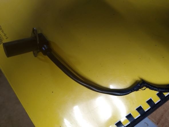

I can see why the cam sensor quit working :o. The break was under a secondary wrap of electrical tape. I put in the new sensor and have spark again. I should have it back together this weekend.
