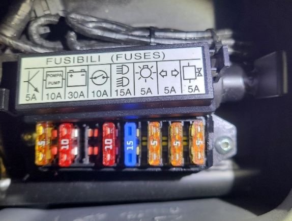

bsanorton 29 Posted March 29 Report Share Posted March 29 Went out for a sunset ride with my buddy tonight. 15 minutes into it the V11 starting to stumble and as I pulled over died. No warning lights. Would not even click when hitting the starter button. After a few minutes it started to click when trying to start like the battery was trying to regenerate. Trailered her home and got 10.8 volts from the battery. Have the Odyssey battery charging and now she slowly turns over. So you know I was having problems with my Odyssey battery. Today it read 12.8 before heading out. The date on the battery is June 2020. Should be good. I'm suspecting a charging issue. PO said the voltage regulator and alternator was replaced. So where do i start? When running the reading on battery was not above 12, might have even been 11.8. Do I start with a new battery or go straight to the charging system? Did i buy a bike with gremlins, oy!!!! Quote Link to post Share on other sites

docc 3,762 Posted March 29 Report Share Posted March 29 A ring terminal left off either the positive or negative side could negate the charging. Also, inspect the green 30 amp charging/regulator fuse in the fuse block. Observe if the headlamp, stop lamp, horn, and tach are all working normally. A faulty Relay#2 (or #1 on the early Sports) can impede charging. When the relay(s) are the fault, the warning light also fails, IIRC. Next most common charging issue might be a failed yellow wire soldered connection coming off the stator under the alternator cover (hard to see!). Mine did this twice Quote Link to post Share on other sites

bsanorton 29 Posted March 29 Author Report Share Posted March 29 9 hours ago, docc said: A ring terminal left off either the positive or negative side could negate the charging. Also, inspect the green 30 amp charging/regulator fuse in the fuse block. Observe if the headlamp, stop lamp, horn, and tach are all working normally. A faulty Relay#2 (or #1 on the early Sports) can impede charging. When the relay(s) are the fault, the warning light also fails, IIRC. Next most common charging issue might be a failed yellow wire soldered connection coming off the stator under the alternator cover (hard to see!). Mine did this twice Doc, do you mean like a missing 30amp fuse? WTH! why would anyone pull that fuse? Paul (KINDOY2)? Thank you Peter Quote Link to post Share on other sites

KINDOY2 392 Posted March 29 Report Share Posted March 29 11 hours ago, bsanorton said: Doc, do you mean like a missing 30amp fuse? WTH! why would anyone pull that fuse? Paul (KINDOY2)? Thank you Peter Actually I remember now..after having the bike in my garage a few months I pulled the fuse before putting it on the charger as I had read that is a good idea to prevent feedback to the voltage regulator..and I simply forgot to put it back in ( I had 3 V-11's at the time and lots of stuff on my benches..including spare's from the tool kit, I remember finding a lose 30 amp on my bench and just figuring it came out of the tool kit...( my memory is for Sht these days)..Not to worry it wasn't intentionally pulled because it was blowing and sold to you with that knowledge..I'm not that sort of guy. Thats probably what the root of your charging issue is..just that fuse...everything else was new before I got the bike from Surj. 1 Quote Link to post Share on other sites
bsanorton 29 Posted March 29 Author Report Share Posted March 29 10 minutes ago, KINDOY2 said: Actually I remember now..after having the bike in my garage a few months I pulled the fuse before putting it on the charger as I had read that is a good idea..and simply forgot to put it back in ( I had 3 V-11's at the time and lots of stuff on my benches..including spare from the tool kit, I remember finding a lose30 amp and just figuring it came out of the tool kit...( my memory is for Sht these days)..Not to worry it wasn't intentionally pulled becasue it was blowing and sold to you with that knowledge..I'm not that sort of guy. Thats probably what the root of your charging issue is..just that fuse...everything else was new before I got the bike from Surj. Thank you Paul for weighing in! That's a big relief. I also found about 10 30 amp fuses in the tail cubby hole. I guess this is why I was having charging issues. I'll put one in and check the charging readings. I also should charge the Odyssey again using my 10amp charger. 1 Quote Link to post Share on other sites

docc 3,762 Posted March 29 Report Share Posted March 29 Simple enough, then! Back in with fuse and do the voltage check that Lucky Phil posted at about 2500 rpm looking for 13.8-14.2 volts. FWIW, I always disconnect my regulator from the battery when charging. As I recall, EME (where I get my regulators) emphasizes this procedure. 1 2 Quote Link to post Share on other sites
