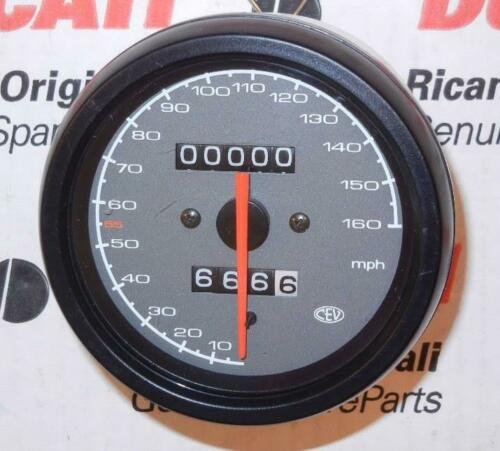

Just an interesting point, the Ducati monster/750ss/900ss CEV / ITI gauges have a metal gear, where the Guzzi one is plastic . I replaced the gears myself in my ITI speedo and it's holding up well, unfortunately the speedo body is 2mm wider otherwise I would have just fit the whole thing!
Here is my ITI speedo in pieces with the new parts fitted.
So that silver worm gear on my (lovely) workbench is actually sliver plastic, whereas the one I fitted from the Ducati speedo is metal.
Likewise for the long gear on the left, the old one is all chewed up as you can see,  It is a weird design as it is tapers towards the bottom end and sits over another worm gear that, without enough grease, just rubs a notch in it over time.
I also scavenged all the parts for the trip reset knob, which works fine now!
  • Thanks 2
Link to comment
Share on other sites
Where does it say ITI on your gauge?
on my hUR/ITI, the "ITI made in Italy" was embossed on the back of the (cheap) plastic container.
Before finding Joel Levine, I was in contact with an Italian shop that does the same thing as Joel, and they told me "ITI" was only manufacturing the container, the actual mechanism was from either Korea or Japan.
I combed the Italian Moto-Guzzi forums, and tried to find an Italian company with an ITI brand name, did not.
hUR and CEV in your case, may have been only doing the face plate's serigraph printing.
Outside container view back
  • Thanks 1
