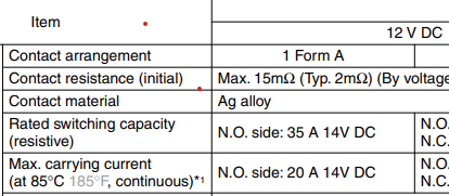

Lucky Phil Posted October 10, 2021 Report Share Posted October 10, 2021 7 hours ago, docc said: Definitely: Please note that the OMRON in the analysis was a G8HN (10/20A Rated Load) , not the High Current G8HE (20/35A). The Panasonic CM series relays are 20/35 rated for continuous/switching. Is this what you're referencing docc? Why can't we use the Panasonics? Are they inferior in some way? Ciao Quote Link to comment Share on other sites More sharing options...
docc Posted October 10, 2021 Report Share Posted October 10, 2021 10 minutes ago, Lucky Phil said: The Panasonic CM series relays are 20/35 rated for continuous/switching. Is this what you're referencing docc? Why can't we use the Panasonics? Are they inferior in some way? Ciao The only Micro-ISO Panasonic relays I have seen posted are Load Rated (continuous current) 10/20A. A true High Current Panasonic (they are "usually" Japanese made) Load Rated 20/35 would be great, methinks! How about a source and a spec sheet? [EDIT: The important rating is not "Nominal Switching Capacity (Resistive Load)", but "Contact Data: Max. Carrying Current". Quote Link to comment Share on other sites More sharing options...
Lucky Phil Posted October 10, 2021 Report Share Posted October 10, 2021 4 minutes ago, docc said: The only Micro-ISO Panasonic relays I have seen posted are Load Rated (continuous current) 10/20A. A true High Current Panasonic (they are "usually" Japanese made) Load Rated 20/35 would be great, methinks! How about a source and a spec sheet? relay info.pdf Have a look docc and see if I'm misled Ciao Quote Link to comment Share on other sites More sharing options...
docc Posted October 10, 2021 Report Share Posted October 10, 2021 Right, see "2. Specifications, Contact Data, Max. carrying current: N.O. Side: 20 amps, N.C. Side: 10 amps." I'm not seeing a "continuous current" Panasonic Micro-ISO relay rated above 10/20. https://na.industrial.panasonic.com/products/relays-contactors/mechanical-power-relays/lineup/automotive/series/2845 Quote Link to comment Share on other sites More sharing options...
Lucky Phil Posted October 10, 2021 Report Share Posted October 10, 2021 7 minutes ago, docc said: Right, see "2. Specifications, Contact Data, Max. carrying current: N.O. Side: 20 amps, N.C. Side: 10 amps." I'm not seeing a "continuous current" Panasonic Micro-ISO relay rated above 10/20. https://na.industrial.panasonic.com/products/relays-contactors/mechanical-power-relays/lineup/automotive/series/2845 I was looking at this in my attachment. Ciao Quote Link to comment Share on other sites More sharing options...
docc Posted October 10, 2021 Report Share Posted October 10, 2021 4 minutes ago, Lucky Phil said: I was looking at this in my attachment. Ciao On that "Max. carrying current" line, slide across to the next column to the right under "12 V DC / 1 Form C" and you will see the 10/20 rating for N.C. and N.O. contacts. Quote Link to comment Share on other sites More sharing options...
Lucky Phil Posted October 10, 2021 Report Share Posted October 10, 2021 16 minutes ago, docc said: On that "Max. carrying current" line, slide across to the next column to the right under "12 V DC / 1 Form C" and you will see the 10/20 rating for N.C. and N.O. contacts. Yes I saw that as well so we need the form C then? I'm probably reading what "I want to read" Ciao Quote Link to comment Share on other sites More sharing options...
docc Posted October 11, 2021 Report Share Posted October 11, 2021 Most important to note the rating for "continuous carry current." Form C ("5-pin/blade") is only required for the front relay on our V11 (Position#1/"Start Relay). Form A ("4-pin/blade") can be used in all other positions, but don't count on them as spares to swap into Position#1/Start, if needed. Mark your 4-pin / Form A relays and know they will not function in the Position#1/front/"Form C"/"5-blade"/Start Relay. Yet . . . even if you fit a "good quality" 20 amp/N.O. contacts, of either Form (A or C), to Position#5/the very back/Fuel Injection&Ignition Relay, we are expecting it to handle 22.5 amps (continuous). Pretty sure the "80% Rule" applies? Any electrical (or other) system will fail if continually run at (or over) 100%. My understanding is that any 20 amp circuit should not be expected to carry, reliably, more than 80% of that capacity (16 amps) continuously. Even in household current. True and reliable Micro-ISO relays *honestly* Load Rated (continuous current) at 20 amps for the (weak) N.C. [Normally Closed] contact and 35 amps for the (stronger) N.O. [Normally Open] contact are quite obviously hard to come by in the "Micro-ISO" size our V11 uses. 1 Quote Link to comment Share on other sites More sharing options...
