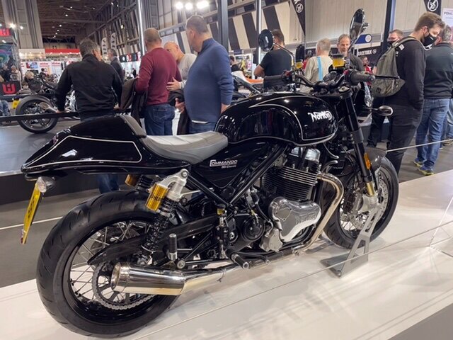

Looking at this bike from an engineering perspective what I see is what I saw when they were first released. Something that looks like a cobbled together backyard special. The Giveaways? the appalling looking banana link gear shift arrangement and the massive rear sprocket. Both indicate a sense of not having the funds to redesign things correctly and having to "make do" with out of date designs and componentry. The massive rear sprocket indicates to me that the primary drive ratio is very long to spin the transmission much faster than normal to reduce the torque loading on the trans to cope with the extra torque from the engine. Then you need to have a silly final drive ratio to bring it back down again. A transmission that's adequate in the first place is the proper engineering solution. A 180 deg crank in this day and age for a parallel twin, no not really.  No balance shafts, pushrods. This is just stuff I see from the outside as an amateur, good knows what the engineering's like inside. Good luck with it if you end up with one though.

The Garner era Commando 961s were little changed from the original Kenny Dreer design (Norton Motorcycles Oregon). The engine is a 270 deg crank pushrod parallel twin with a balancer shaft and a dry sump
The problem is that there was never the budget to properly engineer the power train, and the Garner era bikes are dogged with various quality & reliability problems. A friend of my son used to work for Norton a few years ago, and I have the benefit of first-hand inside knowledge of some of the fundamental technical problems that those 961s suffer from. Unless you want one as an ornament never to ride, I’d never recommend buying a Garner era Commando. However a properly re-engineered Commando with its design and QA problems solved would be a different story. There would be a market for a retro air cooled parallel twin carrying the legendary Norton name, that had been re-engineered to be reliable, and backed up by a company with the financial resource to stand behind their product

Ok so they have gone from a 270 degree balance shaft engine back to a 180 degree engine, is that correct? I didn't look back at the original Garner engine but what you say rings a bell. Personally I don't want a bespoke bike again after the Bimota ownership experience and that had a Ducati engine. I'd prefer a commonly available bike, well engineered and personalise it with quality aftermarket parts if I feel the need. best of both worlds. Decent engineering with hopefully ongoing development and source of spares and the ability to create an individual bike to some extent.

Yea it's a compromise alright. Big sprockets like that compromise suspension settings and suspension performance. Another thing i thought was a "bit naff" as the English say is the oil cooler lines of rubber hose and attached by Cobra clips. I like Cobra clips and use them on my bike for fuel lines but oil lines deserve AN fittings on a bike like this. Just sending me "engineering messages" here and they're not terribly good ones.
