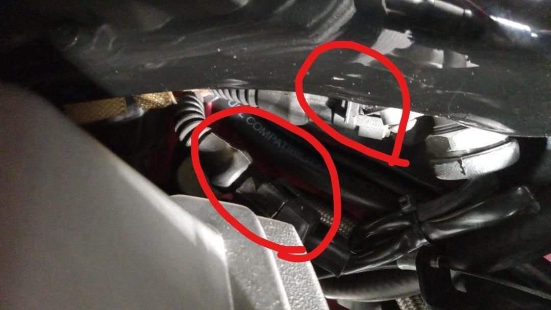

VtwinStorm Posted April 19 Author Report Share Posted April 19 Think I found the offending parts responsible for my being left stranded. Appears the left throttle linkage caused two connectors, one for fuel (?), one for the left fuel pump (?) to BOTH come loose. After some fiddling (thankfully, didn't have to remove the tank), they are both connected again. I will use zip ties to add clearance from the linkage tomorrow and then, cautiously, ride her a few blocks several times. Glad it was obvious what it was, and why it was intermittent---because the connectors were both barely connected! Whew. My first Guzzi crisis cleared, if she runs well tomorrow... 2 Quote Link to comment Share on other sites More sharing options...
docc Posted April 19 Report Share Posted April 19 Not the pump, but the fuel level sensor and the electric petcock. That electric fuel tap was only fitted to the early V11 Sports and many of us decided to go to the manual option to eliminate that point of failure. 1 1 Quote Link to comment Share on other sites More sharing options...
Chuck Posted April 19 Report Share Posted April 19 Are they still using the same connectors that better not be reversed? 1 1 1 Quote Link to comment Share on other sites More sharing options...
docc Posted April 19 Report Share Posted April 19 9 minutes ago, Chuck said: Are they still using the same connectors that better not be reversed? Yes, doesn’t that fry the fuel level sensor? 1 1 Quote Link to comment Share on other sites More sharing options...
VtwinStorm Posted April 19 Author Report Share Posted April 19 1 hour ago, Chuck said: Are they still using the same connectors that better not be reversed? Thankfully....no. Connectors are both totally different, even my stupid self can't screw it up as they won't match. I fired her up in the garage just now...on high enrich/choke...seems fine. It is very wet outside, so my road test will have to wait until tomorrow. I love this machine, and enjoy riding it so much. 3 Quote Link to comment Share on other sites More sharing options...
