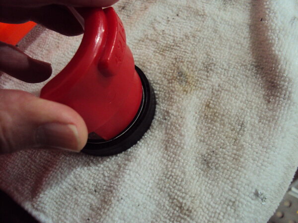

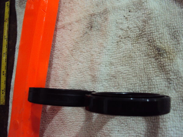

Lucky Phil Posted May 28 Report Share Posted May 28 43 minutes ago, docc said: Yeah, I keep seeing 40-41mm seal drivers applicable to my 40mm fork seals. Truth? Poor images I know but here is the difference between DCY and DC seals. The DC seal has a raised outer sealing lip and the DCY it's flush with the surface. The other image is of my 42/43 seal driver and shows somewhat how it sits almost in the sealing lip spring recess when in use. Not good and will ruin the seal. I didn't even attempt to use it. So the driver needs to impact the seal as close to the OD as possible and still fit inside the fork leg ID. The seals I pulled out of my 43mm forks had been damaged on instillation by the seal driver. This might also be an option. I've seen a Youtube video where the guy used one. https://de.aliexpress.com/item/33007086461.html?gatewayAdapt=glo2deu 1 Quote Link to comment Share on other sites More sharing options...
