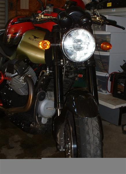

PEPPERONI BROS. Posted February 20, 2005 Share Posted February 20, 2005 I knew there was something goofy about the front end of my V11 Sport but it took awhile to figure out that it was those Alfred E. Neuman front turn signals! The solution is simple, just remove those spacer blocks that hold 'em out there. First remove the headlight, then unplug the turnsignals, the bolts that hold the spacers are on the inside of the headlight brackets, remove the spacers and reattach the turnsignal to the headlight bracket using the original bolt, a spring washer and a 6mm nut, a drop of blue locktite would't hurt either. Replace the headlight, step back and see what the person who designed this bike had in mind! Link to comment Share on other sites More sharing options...

francesco Posted May 11, 2005 Share Posted May 11, 2005 any pictures? Link to comment Share on other sites More sharing options...
Guest Ken Bruce Posted May 26, 2005 Share Posted May 26, 2005 I knew there was something goofy about the front end of my V11 Sport but it took awhile to figure out that it was those Alfred E. Neuman front turn signals! The solution is simple, just remove those spacer blocks that hold 'em out there. First remove the headlight, then unplug the turnsignals, the bolts that hold the spacers are on the inside of the headlight brackets, remove the spacers and reattach the turnsignal to the headlight bracket using the original bolt, a spring washer and a 6mm nut, a drop of blue locktite would't hurt either. Replace the headlight, step back and see what the person who designed this bike had in mind! 43728[/snapback] well i hadn't sussed this one....???? can you put up a picture please? Link to comment Share on other sites More sharing options...

PEPPERONI BROS. Posted August 6, 2005 Author Share Posted August 6, 2005 OK,OK Link to comment Share on other sites More sharing options...
orangeokie Posted August 6, 2005 Share Posted August 6, 2005 OK,OK 57370[/snapback] Now go get some clear lenses and you'll really be cookin' with gas! Link to comment Share on other sites More sharing options...
