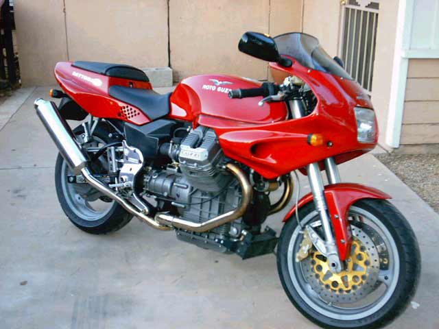

Guest davidb Posted December 23, 2004 Share Posted December 23, 2004 I haven't dyno'ed my bike, but from 40 to 120mph, I can tell a difference in the higher elevations. Rain isnt a problem as there is two water drains on the runners. I have rode it in downpours with no problems. Mine is fiberglass. I had to make a small heat shild to protect it and ensure cool air intake at stop lights. I have posted pics of it on this site. I have noticed alot of calculation and speculation on whether it would work or not. May I suggest that sometimes it is just better to try it, than ponder it. (unless it would Damage your bike) The offer still stands: Anyone that owns a guzzi in my area that wan'ts to test ride mine... can Link to comment Share on other sites More sharing options...
