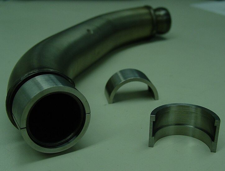

I blew out both of my shims, made a post to the Forum for help, and was referred to Arron Bard (Turtle) - he designed permanent and reusable shim replacement parts. Reference Thread: Floopy cross-over fixed! Fix for cross-over. April 16, 2004 (http://www.v11lemans.com/forums/index.php?showtopic=2528&hl=)
Fast forward:
I found Arron and he found his drawings and we (more him than me) are getting ready to have some shims made. Is anyone interested in buying a set. The more that are made, the lower the per unit cost. Per the reference, the costs are:
4sets for $121 each
6sets for $103 each
10sets for $86

I made the fist seven sets of couplers a year and a half ago when my crossover went floppy. Six others on the forum agreed to buy sets as well, helping offset the cost of my set. The price is driven by the small production quantities and the high precision necessary to make the part seal against the ball. Because of my job I have a good relationship with many shops and was able to get an excellent price for this part.
The only hope I see for reducing the cost substantially would be to install the stainless coupler on one side while using the original gasket on the other. The coupler should limit the movement of the crossover and the resulting wear on the original gasket.
Chime in if you would be interested in the one side solution at more or less half price. I have not yet obtained new quotes for the part but I can’t imagine the cost will go down. I will post the lowest Quote when I get it.

I have a set from the original 7, they have been installed for close to a year now, or about 8K worth of riding. I highly recommend them. They have stayed tight and rattle free since I installed them. The OE sleeves are a graphite/mesh/asbestos like kind of construction and they seem to compress + degrade a little at a time during running. Eventually I couldn't tighten down on the clamps any more for fear of wringing off the clamp bolts. Turtle's design is solid metal to metal clamping that keeps its integrity. Get'em while you can...... :rolleyes:

After looking at my front crossover and the graphite/mesh/asbestos, there was a clear indentation where the crossover wore into the material. The factory sleeves are about 1 1/4 inch long and are straight/smooth. This allows the crossover to be placed where needed for a correct seal (has at least 1/2" of movement per side). The Turtle design is of a different design which the adjustment for width of the pipes is from moving the Turtle seal in and out of the header pipe for alignment.
Wouldn't it just be cheaper to make a metal sleeve but with adding one split in it (for clamping force) the size of the factory ones? :huh2:
The costly part of the Turtle seal is boring the recess in the middle for the crossover ends.
