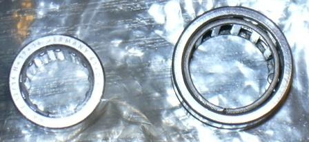

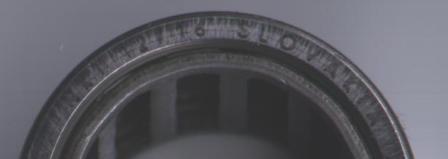

I've just gone through the new bearings now that I've got the old pinion bearing out and noticed the new pinion nose bearing is the wrong size !! (the 12/16 needle roller)pinion_nose_bearing.JPG
If you've got one ordered you may want to cancel it for now, unless there are two types of bearing (which seems unlikely) it would appear that the list I got from Jack was wrong for this one.
The writing is very small on the bearing but it looks like 27 16 to mebearing.jpg
I'll try to match it at the local bearing supplier and let you know . :bier:

I talked them through the exploded view picture on the phone so don't know the number, but maybe when it arrives ?

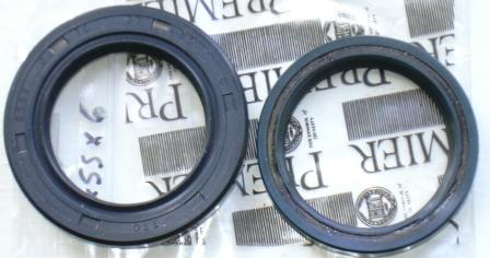

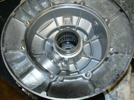

One of the seals is wrong also :homer:
Its the seal pressed into the casing behind the big roller bearing that supports the crownwheel shaft.seal_location.JPG
Now that I have it out it looks like a 40x50x6 (no markings so measured) not a 37x55x6 as I was told, the other bearings and seals look ok so far.

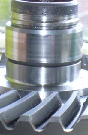

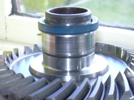

The inner race on the pinion is difficult to remove as is the inner race on the crownwheel assembly inner_race.JPGas they don't have anywhere for a puller to grip, I'll seek help getting these off I think.
All the other bearings are out so when I've sourced the pinion nose bearing and the correct seal I should have all I need to start putting it back together.
Jack has solved the bearing size issue, it should be an "I 12/16" bearing not a 12/16 (the I means it has an internal race and this makes the whole bearing bigger)
The seal is actually a 38x50x7 (its written on the inside behind the spring :doh: )

I brought the issue of the inner race up with Jack on Monday morning as it appears Rossoandy didn't order or query the lack of the inner race on his order (we assume he reused his ?)
The ring comes out quite easily(it may make a bid for freedom if your not careful) but the inner race does not !
I used a grinder and then heat to crack the race but its really close to the seals location so disaster is a real possibility, it would be better to get a bearing separator/puller as the inner bearing race on the pinion is the same !

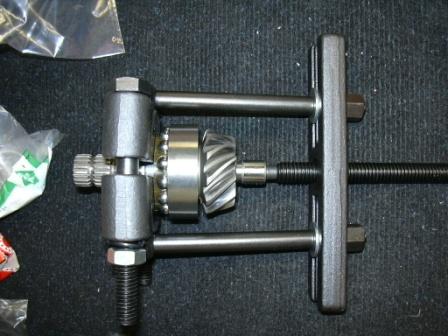

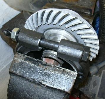

Well the box is back together.
I bought a bearing separator/puller to go with my existing puller, these combined with my vice and a little bit of lateral thinking made the job possible.
Pinion.JPG[ crownwheel.JPGOld_Bearing.JPG I used the old bearings to protect the new bearings that had to be tapped into place.
The case seals and bearings went in quite easily, the pinion and crown wheel inner race pressed into place with the separator and vice or puller with little effort but getting the pinion into the case proved tricky as I didn't want to use a hammer or push inner bearing race. In the end I used the bearing puller with one leg into the case opening and the other under a slight lip on the case outer (remember the case isn't thick at the opening so be gentle and take it slow !!) to press the pinion into the case by using the castleated nut upside down with various washers and a socket to load only on the outside of the bearing (making sure it went in straight so the pinion nose bearing lined up), once it was far enough in to expose the thread I turned the nut the correct way up and pushed the bearing fully in by tightening it (while gently heating the case with the heat gun).
Just got to put it on the bike and tighten the pinion nut up against the brake.
So basically buy a puller and a separator (I wish I'd bought it earlier to remove the old bearings rather than using a grinder :homer: )
