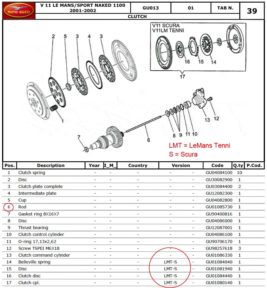

slowkitty Posted June 12, 2015 Share Posted June 12, 2015 Great list by Camn ... isn't a longer pushrod (01 08 57 30) from a twin-plater needed? Cheers Link to comment Share on other sites More sharing options...
Camn Posted June 13, 2015 Share Posted June 13, 2015 Isn't a longer pushrod (01 08 57 30) from a twin-plater neededThis has also been discussed on the German V11 site but I have never seen any part number for a push rod for the single plater. I felt that the push rod should be a bit shorter for the two plater, since I had to adjust the lever (the screw on the handle which pushes the main cylinder) so that the clutch would not catch so "far away". I was used to a different position (clutch engagement) with the single plater. Here's a page from a spare part book for 2001-2002 V11 models: No remarks = All models "LM/SN" = V11 LeMans/Sport Naked “LMT/S” = V11 Lemans Tenni/Scura Link to comment Share on other sites More sharing options...
