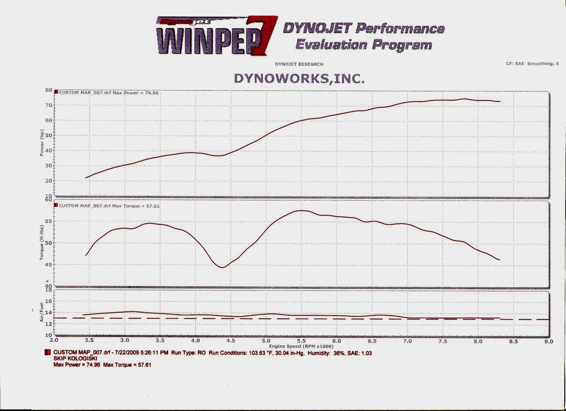

Karl Von Posted July 27, 2009 Share Posted July 27, 2009 Here is a print out of my brothers 2001 Rosso Mandello. The bike is all stock Link to comment Share on other sites More sharing options...
