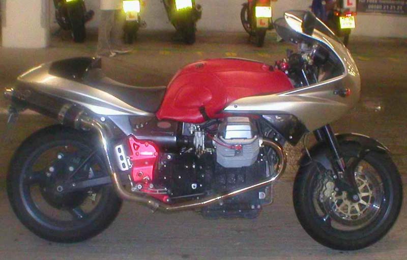

  8. hi, name is chris... started biking 21 months ago on a cali special...couldn't have any weight on wrists due to shattering incident 4 yrs ago then i saw the v11 lemans and needed it... now have regular visits to my doctor for big ass pain killers. had a little incident with my lemans and my wifes car last month...hence the slightly different colour of my bike...appoaching 20k miles in as many months, so am not pee'd off too much about the accident, but am worried about how much the insurance will be next year!!! in process of tidying up the rsend of the bike...getting the number plate/rear light bracket chopped down to bring it closer to the undertray, and waiting on mistral x over. absolutely love my bike...wouldn't have any other....and hoping the summer here won't end.
  9. these were made by renegade, including new crossover and additional piping... http://www.renegade-products.com have ure speakers on when you open the site, and imagine a guzzi attached to the end of that noise...rocking
